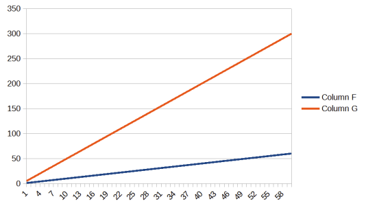

I know how to calculate the correlation coefficient but that doesn't tell us what you seem to think it does. You can't use strong correlation to mean small variance between data sets (e.g., that the trend of one can be replaced by the value of the other).
To visualize this, take the following data sets:
They have perfect correlation (coefficient = 1). However, one does not represent the growth of the other in absolute terms and the data sets diverge significantly over their range (they just do so linearly which is why they have a correlation coefficient of 1). What you are claiming cannot be supported by calculating the correlation coefficient, especially when the data set is ridiculously small which makes the coefficient basically meaningless. I thought showing the projected Cinebench IPC numbers based upon past generations would make that obvious, but I guess not. Maybe if we look at it from already known values.
Let's take the first two generations calculated and pretend like Zen 2 hadn't been tested with SPECint yet. If Cinebench is a good representative of SPECint IPC increases, then we should be able to predict Zen 2 SPECint IPC based upon the Zen+ to Zen2 Cinebench numbers.
They have perfect correlation (coefficient = 1). However, one does not represent the growth of the other and the data sets diverge significantly over their range (they just do so linearly which is why they have a correlation coefficient of 1). What you are claiming cannot be supported by calculating the correlation coefficient, especially when the data set is ridiculously small. I thought showing the projected Cinebench IPC numbers based upon past generations would make that obvious, but I guess not. Maybe if we look at it from already known values.
