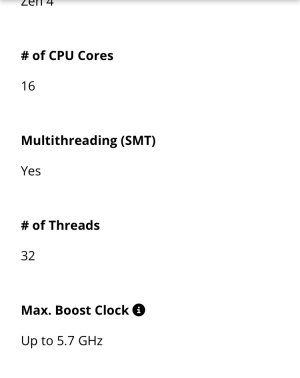

Fmax for the 7950x is 5.8GHz, but I'm using the boost clocks as measured and reported in the Anandtech reviews.
7950x has fMax at 5.85 GHz. Anyway, using that number I get 1.2279*5.05/5.85 = 1.0599. So the ccaluclations agree.
The Fmax is not guaranteed and Anandtech’s sample does not boost that high. They measured the single core boost of their sample at 5.75 GHz so I don’t know why you would use anything else except to try and get the result you want. . . .

AMD advertises 5.7 GHz, anything above that is not guaranteed and varies by sample. Anandtech actually measured their sample at 5.75 GHz boost so taking any other number makes no sense.

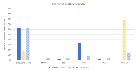

FWIU, these Cinebench figures are just an individual's opinion, nothing more. So why getting worked up so much about them?
On possible Cinebench performance of Zen 5 (although I am not one of those who buy computers in order to run mostly Cinebench all day):
  • If there will be 512 bit wide FP datapaths in Zen 5, can Cinebench (release XY) actually make use of them?¹
  • If yes, do all Zen 5 products have the same FP pipelines per core? An earlier rumor spoke of 512 bit FP option or something like that. And I keep wondering what that was supposed to mean.
¹) More general question: Back when Skylake-SP introduced an extra 512-bit only FMA unit per core, only AVX-512 enabled software could make use of it. Will Zen 5's widened FP pipelines have the same limitation WRT existing FP code? (In the past, Zen was all about balanced design…)
C&C has an article on Cinebench and what instructions are in it:
https://chipsandcheese.com/2023/10/22/cinebench-2024-reviewing-the-benchmark/
Based on what I understand from reading the article, it doesn’t appear to leverage AVX512.

Well, it remains to be seen whether or not the (rumored) 512 bit wide pipelines can be split into two 256 bit pipelines each. Maybe not, if frontend as well as load/store/cache/memory, despite whatever upgrades Zen 5 will feature in these departments, won't be able to keep up with it in typical¹ FP workloads.
Edit: ¹) "typical" not from random consumers' viewpoints, but from the viewpoint of AMD's product management. Market segments which may be less in the public focus but are attractive to AMD to cater to could play into such feature decisions. E.g., perhaps the FP-side updates will be more effective in their V-cache equipped products than in others.
