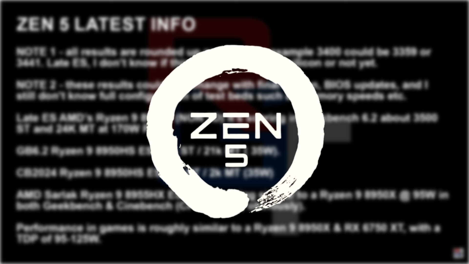

3500 is for Strix I guess?
Phoenix is doing 2600 in GB6 ST.
3500 is a 900 point increase, aka about 35%, which fits with the IPC gain rumours.
Dang, that's pretty solid. PHX gets about 5.1 GHz ST boost if I recall correctly for the 8840HS. If DT Zen 5 has a small or non-existent clock regression (i.e. 5.5 GHz) then it should hit 3700 points.
Fjodor2001
Feb 6, 2010
4,622
745
28,174
19,218
Where’d you hear that?
Very late Engineering Samples of AMD’s Zen5-Flagship, the Ryzen 9 8950X score 3500 points (ST) and 24k points (MT) in Geekbench 6.2.
Of course, take that with a boulder of salt.
P.S. And just like that, I discover that there is a company called https://www.bouldersaltcompany.com/
