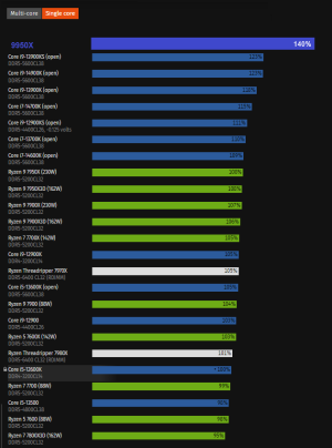

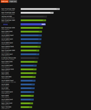

I guess it's time for my likely very wrong performance projection for Ryzen 9950X :). The streak was always going to end, why not with Zen 5.
Link to the doc ( I reused my previous doc for Zen 4 projections with very minor adjustments)
Computerbase data
Zen 5 core to have:
34% higher ST IPC (geomean for desktop, as AMD always calculates it)
25% SMT yield (same as Zen 3); Zen 4 has 34% SMT yield
Desktop TDP of 170W and 230W
Max ST clock of 5.5Ghz
MT clock of 4.8Ghz for 170W and 5Ghz for 230W variant
ST and MT projections done for the lower TDP model that boosts MT to 4.8Ghz
Versus 7950X (vanilla):
29-30% higher ST performance
15-16% higher MT performance
Notes:
1) I picked 34% ST IPC increase versus Zen 4 because Zen 5 is a monumental change in almost all important aspects that were bottlenecks in previous Zen cores. There will probably be some disappointing IPC jumps in specific workloads and some outrageously high increases in others, but I think that geomean will land in lower 30s percent.
MT IPC should be lower as I think Zen 5 will have lower SMT yield (in line with Zen 3, ~25%) : 1.34 x 1.25 / 1.34 ~= 1.25 or 25% versus Zen 4.
2) My numbers for 7950X on ST chart are from the actual Computerbase results (latest update from their webpage), and not from my projection sheet (document) for 7950X. Because Computerbase uses a specific non-favorable to AMD ST benchmark selection (mostly Cinebench aka Cinememe), actual ST index they got is ~7% lower for 7950X versus 5950X than what IPC x clock difference should show ( 1.1 x 5.7 / 4.9 ~= 1.28 or 28% )
