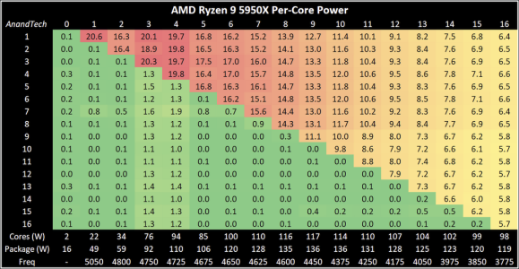

Likelihood of increasing IPC while decreasing power is low.
Zen 3 vs. Zen 2
  • 19% IPC increase
  • same node class, but improved
  • slightly higher clocks
  • bigger die
  • ISO power
  • right in our face
