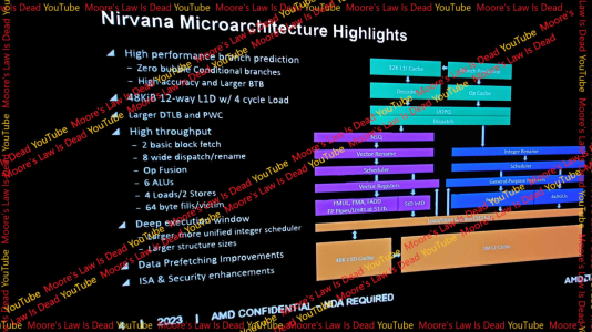

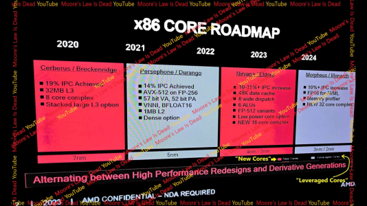

Might as well show the slides MLID revealed so that we're all on the same page regarding what's discussed:
Edit: Had some time to look at the slides more closely and here's my thoughts.
1) That timeline slide... The years seem off. It's almost the end of 2023 and Zen 5 isn't even out yet, which suggests that it's either a fake slide, this timeline isn't to scale, or it's out of date. Seeing as how Covid delayed things, if it's an out of date slide, it probably dates to sometime before Covid.

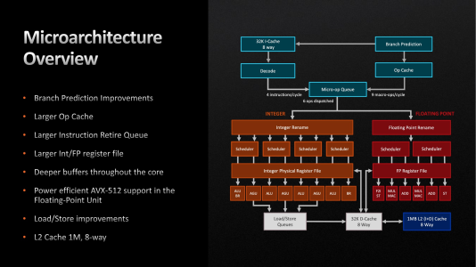

2) Regarding the Zen 5 block diagram, here's Zen 4s for reference.
Zen 4 has 4 ALUs vs 6 for Zen 5.
Zen 4 has 6 op dispatch vs 8 for Zen 5.
Zen 4 has 3 load, 2 stores vs 4 loads, 2 stores for Zen 5.
Zen 4 has 32 kib L1D cache vs 48 kib for Zen 5.

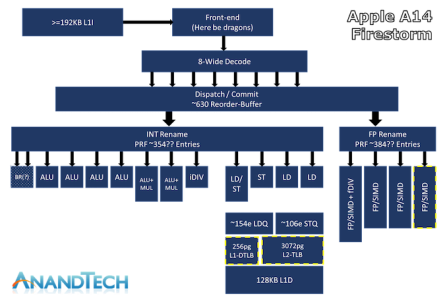

Yes, Zen5 looks for the most part similar to Nuvia Phoenix or Apple Firestorm/Avalanche/Everest 'cept the non-baby mode FPU.

So, if the slides are to believed (and they look quite authentic), the core ends up being much more similar to Alder Lake than I anticipated. But still noticeably fatter.
  • The same 12-way 48KB L1 cache as Colden Cove (hopefully without the latency penalty)
  • 8-wide dispatch (+2 vs Alder Lake and Zen 4)
  • 6 ALUs (+1 vs Alder lake +2 vs Zen 4)
  • 4 loads / 2 stores per cycle (vs 3/2 for Golden cove, 2 /1 for Zen 4)
    • - if I'm reading this right, these are 512bit (64 byte) ? That's a massive uplift from Zen 4 if true (4x the throughput in ideal AVX-512 scenarios)
The biggest unknown for me is how do they plan to feed the beast? There are no mentions of any decoder changes, surely it would be an absurd bottleneck, if not changed?
Anyway looking forward to comparisons to the Arrow Lake core. In the end, they couuld end up pretty similar in width - so it would all come down to execution.
Gideon
Nov 27, 2007
2,044
5,103
Hmm, Have I misunderstood it. I always thought i'ts two 256-bit loads and one 256 bit store:
This is likely because AMD didn’t implement wider buses to the L1 data cache. Zen 4’s L1D can handle two 256-bit loads and one 256-bit store per cycle, which means that vector load/store bandwidth remains unchanged from Zen 2. The Gigabyte leak suggested alignment changed to 512-bit, but that clearly doesn’t apply for stores.
