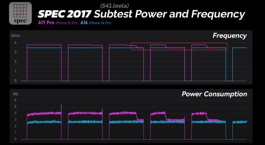

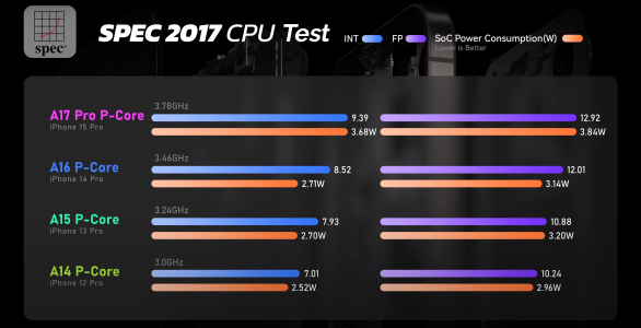

Honestly the intel projection slides seem off to me. 3 nodes jump with a complete core redesign and the best they can come up with is less than 10% ST?
It's not 3 node jumps, it's at best advancing things by 1.5 nodes. So far the performance results measured from the A17 on N3B gained 14% more performance in exchange for 35% more power in Specint, while gaining 9% performance for 22% more power in Specfp.
It's on N3B, which currently seems to have the same performance as N4P. I'm attributing some of the poor performance of the A17 to bad yields forcing it to run higher than ideal voltage. I'm assuming that by the time ARL-S comes around yield improves, which is why I'm saying it's basically 1.5 nodes ahead of current Intel 7 instead of just 1. I could make a compelling argument that it is a single node jump from the Intel 7 that's shipping with RPL-R though.
Zen 5 legitimately has the better process tech for this upcoming generation. All things considered I'd take N4P over the early version of N3B that ARL-S is stuck with.
Edit: Changed second image to just SoC power and not motherboard power.
This seems like a super rare "off" year for Apple. And as far as I know the CPU isn't changed much in design at all. More of rebranded A16 set of cores taped on N3B.
I'm sure Apple will switch to N3E next year along with everyone else. That being said, if N3B is this bad while being expensive I can see why everyone balked at using it. A rare loss for TSMC as well.
