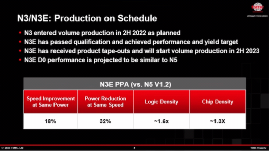

If A17 is going to be on N3E as soon as that process is available, I still think it is quite likely Apple does not produce any N3B M3s and they are all N3E - to avoid the cost of having two versions of that design.
If there are no M3 Macs announced next month I think it is pretty safe to say we won't see them until next spring and if so we will know for sure they are N3E.
We will see about Intel. They may have decided to wait for N3E to avoid dealing with the issues of N3B. Apple was willing to do so because they needed the density for A17, but we've all seen the rumors that it will switch to N3E next year.

I don't know if Apple would bother doing a redesign of A17 on N3E. By the time they could, they'd just as well make A18 instead. It seems like everyone is avoiding N3B like the plague and TSMC probably can't wait to get rid of it.
It does mean that there's going to be more of a delay for AMD (or other companies) to get out products that aren't on N5 (or one of its derivatives) and potentially means that it may take until 2025 for some parts.
Turin-Dense is N3E and H1 2024.

Is 3NE going to be ready in time for that? I e seen posts in other threads suggesting that the 3NE node would only be ready by mid-year. I don't know if that was based on anything other than speculation or rumors though.
TSMC said in July that N3E is starting volume production in Q4.
