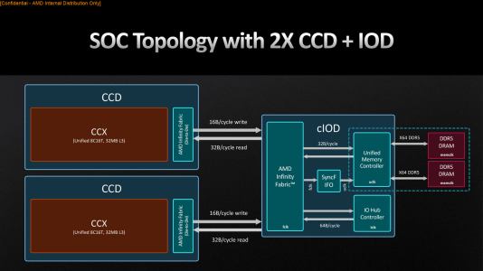

With DDR5 8000 at 2000MHz FCLK the X3D CCD gets 64GB/s and the c core CCD gets 64GB/s. The X3D CCD is not very memory sensitive, so for most tasks it has more bandwidth than it knows what to do with. The c core CCD cannot use the leftover bandwidth from the X3D CCD though, so it's not as simple as 50% more bandwidth feeding 50% more cores.
So, assuming that Zen5c is about as memory sensitive as Zen4 is, 2000 FCLK would be roughly equivalent to running Zen 4 at DDR5 4000. Not crushing, and plenty of tasks wouldn't mind, but not great either and a good number would be constrained. To the extent Zen5c may be more memory sensitive than Zen4, things start to get a bit more ugly.
If you can push FCLK up to 2666MHz for a 1:3 ratio with DDR5 8000, then the c core CCD could use around 85.33 GB/s or that, of roughly equivalent to DDR5 5333, which sounds fine for the vast majority of tasks.
Something like 2333MHz FCLK 1:3 ratio with DDR5 7000 could be a more realistic middle ground. Now the Zen5c CCD is roughly equivalent to a 16-core Zen 4 running DDR5 4666.
It may or may not be possible, but it could help binning if only one IF link needed to be validated to run at 2333MHz+ and you could use different ratios for each CCD.
Running this theoretical processor below DDR5 6000 and 2000MHz FCLCK is not something I'd recommend.
But, even at 2000 MHz FCLK, I don't see that making this hypothetical SKU *bad*. Those 16 cores won't be at their best, but will still usually beat 8, will be more energy efficient, and by running at a lower frequency than the X3D CCD, won't be a scheduling mess. Game performance is better, and you have more total compute. The main downside is that for single threaded tasks which don't respond to V-cache, performance will be lower than a regular 8950X with two normal 8-core CCDs due to the V-cache frequency hit.

2 x DDR5 8000 == 128GB/s == 2 x 2000 MHz IF links.
Ehhh someone forgot about IMC efficiency limits, especially in geardown modes.
with a more mature node
N7 is 5 years old, it can't be 'more mature'.
they certainly could if they wanted to for a halo part (Eg. bin for something like 2666MHz FCLK, which would give the same 1:3 ratio for DDR5 8000 that AMD recommends with DDR5 6000 on Zen 4).
why.

Sorry, that's a big load of BS. Zen4 runs decently as low as DDR5 5200, while Zen5 should fairly easily run at DDR5 8000 or higher. A X3D CCD is far less bandwidth (and latency) sensitive than a non-V-cache CCD, and Zen5X3D should be noticeably less memory sensitive than regular Zen4. Zen5c is probably somewhere close to Zen4 in performance, but I'd guess may be a bit more memory sensitive depending on various factors (Zen5 architectural/lower level cache changes/whether we're still doing 2x 16MB L3s (probably) vs. a single 16-core CCX that shares the full 32MB).
But the point is, in a hypothetical part that mixes a Zen5X3D CCD with a Zen5c CCD, you're increasing core count by 50% and bandwidth by about the same via more mature DDR5. The important CCD (the X3D one) should be quite a bit less bandwidth sensitive than regular Zen4, while the c cores may be slightly more sensitive. Back of the napkin everything basically evens out. But even if it doesn't quite even out in the real world, being a little bit bandwidth constrained in some tasks is hardly going to make the product suck, it would just be slightly less awesome (with the potential of becoming more awesome in the future with newer AGESAs and even faster memory).
I suggest you email Mike Clark and suggest he's a dipstick for mentioning the bandwidth issue in the first place.
No, it's not 100% efficient, but it can be utilized. 1:3 helps which is why I brought that up initially.
No, it uses N6, and iirc was one of the first to do so, at least in the PC space. You can expect derived nodes to be comparatively more mature when they launch, but not fully mature.
Explained earlier, and also in the post above.
Ryzen 9 only, and Read only, and theoretical only.
Ryzen 7 (1 IFOP) can write to memory at most 32GB/s unless I'm missing something.
Edit: i'm definitely missing something, in some reviews r7 7700x gets 60GB/s write speed in aida memory test. Can anyone explain why?
And Buildzoid says that the ram and ifop are completely decoupled in am5, there's no benefit to syncing them like on am4.
How so? Afaik clock-domain crossing latency has always been an issue (FIFO), and btw, all uncore clocks can be decoupled since Rome.
