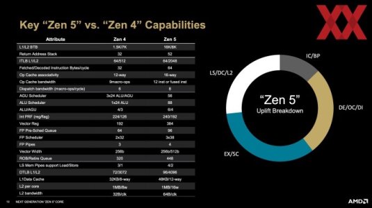

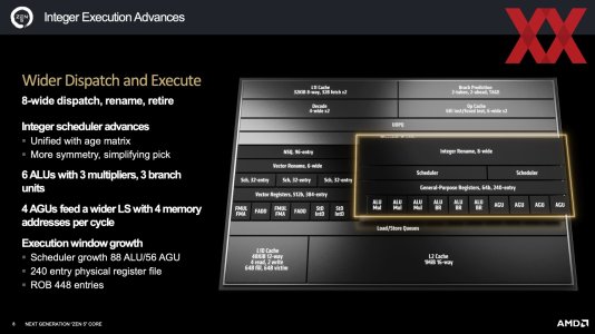

Although it is not on the slides, according to THG the Reorder Buffer has 448 entries.
Haven't had the time to watch the CnC video but I guess they might provide some more figures as well - or in an article later on.

I think, CnC will elaborate on that in their written article later on. But from the video it was a rather clear "yes". For a full confirmation, micro benchmarks will be needed.

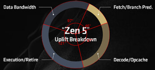

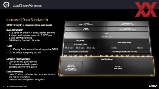

Some rough math (normalized to 16% IPC gain):
Component​
Portion of Total IPC Gain​
IPC Gain​
Fetch/Branch Prediction​
12.8%​
2.05%​
Decode/Opcache​
26.8%​
4.29%​
Execution/Retire​
33.6%​
5.38%​
Data Bandwidth​
26.8%​
4.29%​

Look at this. A whole 2% gain for fetch and branch prediction. This is how CPU designs are.
And why we scrutinize every way the parts are tested. Because maybe using a slow SSD instead of a fast SSD would result in "Oops! There goes all the gains from the branch prediction unit!".

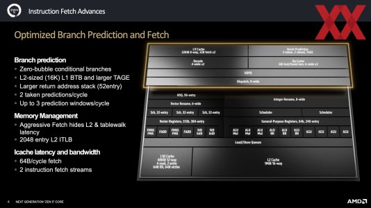

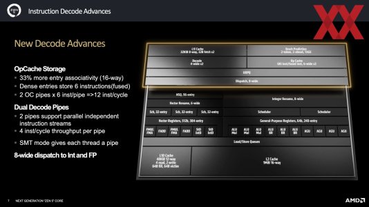

At 2:10 in the CnC's video Mr. Clark clearly states they still do decoding in-order. What does that mean in context of Tremont+ style of fetch & decode?
I interpreted that as meaning you still have fetch ---> decode, which is in-order, but there's two parallel paths now instead of one, meaning you have a dual-ported instruction fetch feeding into dual decoders. I also interpreted Mike's following statements about each decoder knowing where to start as meaning both decoders can work on the same instruction stream.

for those wondering, it sounds like from the interview, that zen 5 is 8 wide decode, but can only decode from one branch path of a single thread at a time per that decode unit. so real world gains would still be only around the previous zen 4 offerings of 4x ILP.
I again want to know why David Huang's results showed zero parallelism from the two clusters in ST. Is it disabled in mobile or does it only work situationally?
If it only works situationally then they decided to do so to limit increase in resources and leave it for future generations when process advancements give them more room. And with SMT they still could take full advantage of it.
Going from 1x9 throughput uopcache to 2x6 throughput uopcache is also an SMT minded decision, because with ST, it would be a downgrade. The BPU can also fetch twice as much as before, fitting the dual cluster setup.
As far as I understand, entries in the uop-cache contain up to N consecutive instructions starting from a given address, but it may contain less instructions if:
- An instruction crosses a cacheline, or;
- There is a branch in the instruction stream, or;
- The current entry doesn't have enough space to hold an instruction that is decoded into multiple uops (probably rare though).
So if the new uop-cache can, when operating in 1T mode, retrieve two consecutive entries or entries across branches, then it's actually a win in every case. And it should be quite doable since the BTB already has the target address of the next branch.

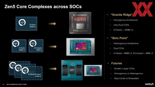

Sorry for double posting, but I think this information is of value for this thread as well:
In the linked article, Mike Clark indeed confirms, that they have 4 designs for Zen5 altogether, because they cut down AVX512 on mobile Zen5 and Zen5c:
For what we’re launching today in Strix Point, both the performance core and the compact core both have the AVX cut-down [AVX-256] because they're in a heterogeneous situation, and they're in a mobile platform where area is at a premium.
