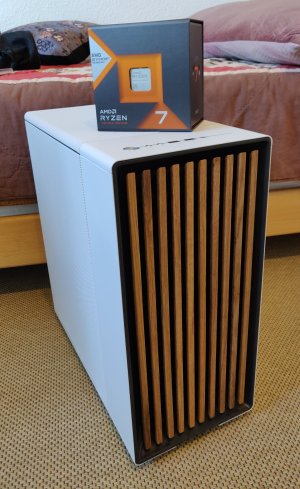

I picked up a 7800X3D. Man RAM is really tall. With my old 3090Ti, it should be a decent upgrade from my 9700K/GTX 1080.
you can take a band saw or angle grinder to the sticks. they won't work anymore but the height won't be an issue any longer.

I agree, but each to his or her taste. And since I didn't want an ITX build, then it would be somewhat difficult to hide an ATX case and still be able to dissipate the heat, so I chose the case with the best looks.

It's $30 more expensive than a similar case like the Lian Li Lancool 216, and when spending +$2000 building a new computer, I don't mind paying an extra $30 for a nice finish, then spending hours modding and gluing wood on a case :p
substance over style old bean. me, I'll take a generic looking case with adequate ventilation. nothing that can't be overcome by a field torch, metal snips and power tools.

I neither have the time or mad skillz for that kind of project :p
