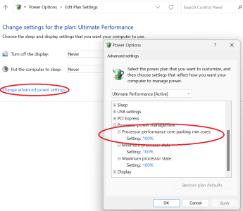

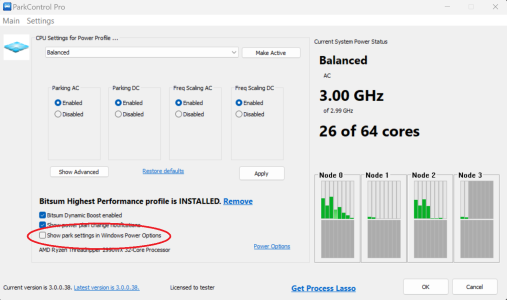

Jayz latest rants. He has some nuggets regarding AM5, like, do a fresh format when adding an X3D CPU (doesn't apply to Linux, Mark).
He mentions that he had would have to reinstall windows as a means to get a 7800X3D to work after using a 7950X3D. Steve of GamersNexus said the same thing. Even after uninstalling the AMD chipset X3D driver they say half the cores were still parking on the 7800X3D. They too fixed it with a Windows reinstall.
I can tell you that is not needed. What appears to happen is that either the AMD chipset driver or Microsoft Game Bar sets the core parking min cores for the Windows Performance Options profile. Uninstalling the chipset driver leaves the setting behind.
I was able to control the parking behavior in my "Ultimate Performance" profile by downloading ParkControl and enabling "Show park settings in Windows Power Options".
I can then control it in Power Options. The parking algorithm is disabled when set to 100% as outlined by Microsoft here,
