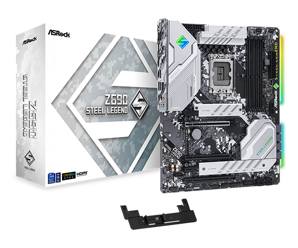

For me the Steel Legend ASRock boards give the best options for the money. You get gen 3/4/5 slots for use and gen 4 M2 slots for drives. There's one standout though that has a Gen5 M2 and that's the Velocita. The newer 790's might have more options as far as models that have the M2 slot w/o needing to use an adapter. The biggest issue of including these is the lack of PCIE lanes to support more than a single M2 Gen5.

There's 2 flavors one w/ WIFI and the other w/o. Not much of a price difference and I went with the one w/o wifi since I had a M2 / antennas already and added it instead of paying for it.

So, of the boards I listed the Steel Legend might be the best choice. I'll look at the options. I definitely don't need wifi on the board, as I'm not a wifi kind of guy if I can help it.
I'm going with the Steel Legend. I have it in my car but man, I should have bought the 12500 a couple of hours ago. It was in stock at Newegg now it is gone. There is a third party that is selling it for a good price also, but then you do the Marketplace thing. What would you do? Wait for Newegg to get stock back in, or order from the third party? Damn, sometimes I just piss around too much.
