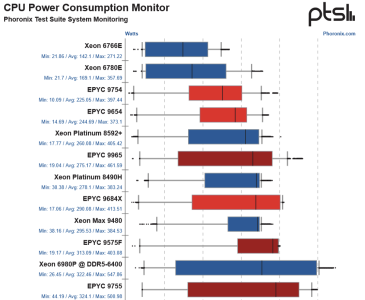

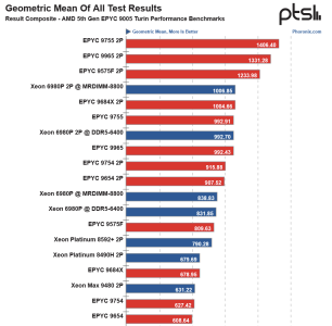

where does ARM wins in perf/watt Turin Dense buries ARM DC CPU deep

So why did you link me to that website?
I thought phoronix would have the data cause they usually have the data but as it turns out it was vCPU so my bad.
Do I need a public letter like Lip Bu Tan for you to forgive me 🤣
Don't need an apology letter. Just need you to come with more firepower.

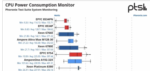

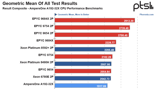

It's hard because getting independent testing of Arm server hardware is difficult now due to a mix of AMD's competitiveness and hypervisors rolling their own versions of ARM processors. This is the best comparison I know of:
So, not that far off in a general sense, but Zen5c would be a significant improvement over everything shown here. With Ampere being bought-out by Softbank, it will be interesting to see if they can get more traction for 3rd party ARM solutions and improved release cycles.
