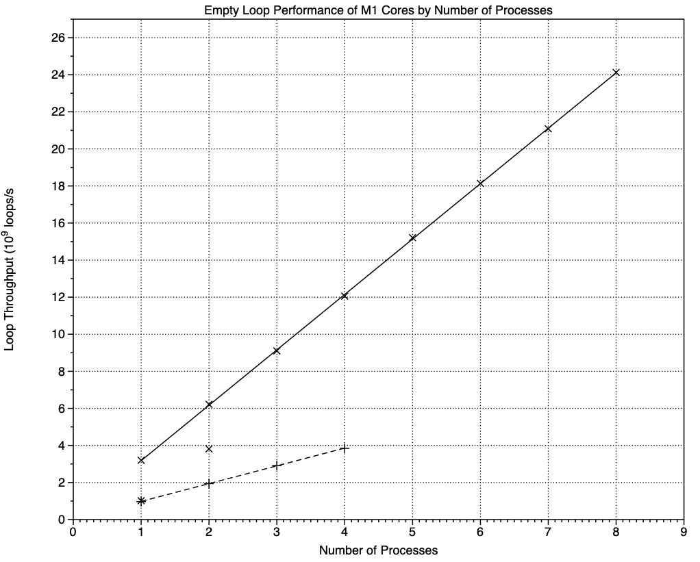

The author of those there seems to be wondering this as well. In a recent article he shows that two Icestorm cores in Pro/Max are allowed to match four :oops: Icestorm cores in base M1:
That is indeed very strange, using a second E core increases performance by 4x. Obviously some weird testing artifact, but I can't come up with anything off the top of my head.

@moinmoin
After reading his latest article I have to agree - this is indeed very weird. I am also wondering why this has not occurred to anyone else up until now. Would be interesting to see if this behaviour could be observed in high level benchmarks like Cinebench et. al. as well.
Assuming that the measure is accurate it could just be a good indication as to why there's no need for more than two efficiency cores. Perhaps after going with four cores Apple realized that they weren't actually able to fully extract the theoretical performance they originally predicted and that it would be possible to see nearly the same actual performance from only two cores.
Maybe there's a very good reason for that and it's something that could be solved with sufficient changes once the problem is fully understood, but maybe Apple hasn't been able to work out exactly what those changes need to be or that it's a bit more tricky than we might think and require more time than Apple had.
