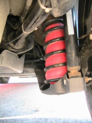

i put the 1000s on a chev. and i had the 5000s on another. the 1000s seemed to keep getting holes from nothing. the 5000s were much better. not sure on the suspension setup on those. McPherson? or separate shock/spring? will be interested to see how you fit them. it's a cool rig to keep around.

they fit right inside the rear coils so size matters.
They do leak at the top of the bag connection, people have added fix-a-flat on some. it is a big community with lots of fun stuff and the utility is hard to beat for a $3000 beater purchased many years and miles ago. I think it had 130K when I got it, now at 180.
50K miles @ ~46 MPG it has saved me some coin.
nice. hopefully they hold up. maybe the red ones are better now. do you put some kind of puck on top and bottom to protect them?

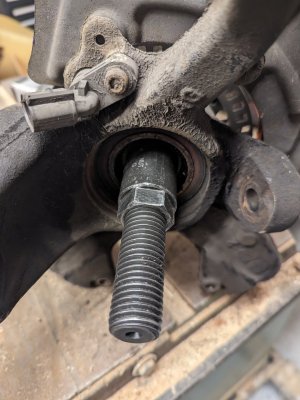

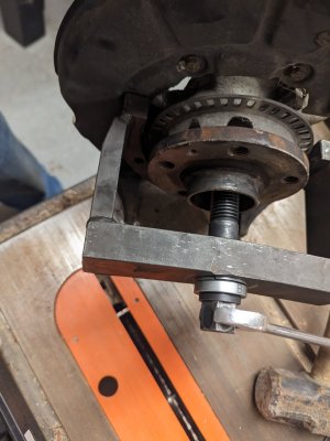

I rented a tool from Orielly to pull the front bearing and spindle apart. The outside inner race pulled out of the bearing assembly so I will have to grind and split that off the spindle.
