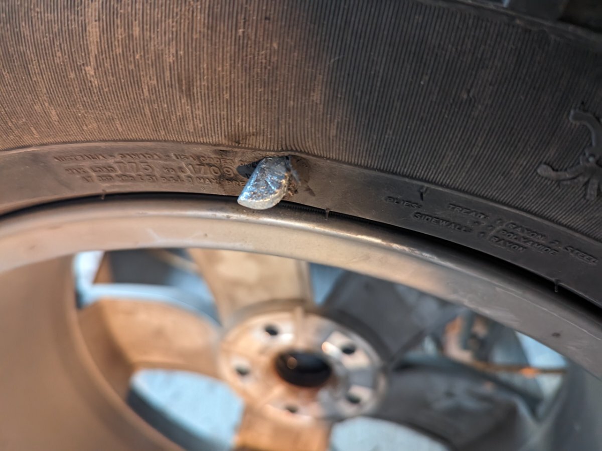

two weeks ago Darling Wife came home with a low tire warning on her VW.
I pulled it off the car and found it, a tiny little tube like a big hypodermic needle that both opened a hole and kept it open.
Driving home today she noticed a noise out in front of Les Schwab and Firestone, and within a few miles the same tire shows up on the display. I check it at Safeway and decide to run for home.
It is flat when she parks it. I put air and find a big leak in the tread

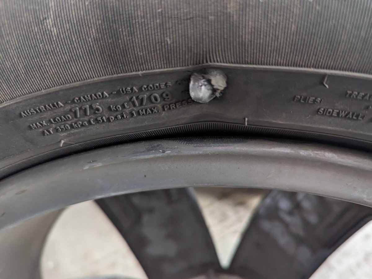

and then spotted this!
I grabbed some pliers and this is as far as I got. I think it is a steel wheel weight and the clip is hung up and I can't pull it through.
I had never heard of a steel wheel weight, but when I searched I found out they are a thing now.
:angryfire:
Those tire shops are seeding the road now.
My tire shop has a used 235/50R19 which is hard to believe, but welcome. I can get another season out of these tires and I also have a spare set of 17's with the same diameter tires on them to put on also.
Pulled a 2" lag bolt out of one of the tires on my wife's car last week. Lots of construction around here, and unfortunately too much of their stuff ends up on the road. A single plug fixed it, thankfully.

The tire shop charged me a flat $50 for a decent replacement, mounted and balanced. Can't beat that with a stick.
They said those steel weights do not stay on as well as the old lead ones. They for sure are a lot more lethal for the tires, when they do end up as a road hazard.

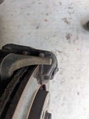

The brakes have been on a short leash and the other day they made the noise, so it is time to get with it. The neighbor will free up his lift and we are going to town on it.
pads
rotors
front calipers ( one side wore out quicker than the other )
struts all around
lower control arms complete with new ball joints
I've never been a knee jerk caliper replacer, but the right wore out both pads about 1/8" faster than the left.
Heavy metal to metal!
She's been a bit bob-by and weave-y for a while now, and with 180K+ and 21 years on original struts it does not surprise me.
Going with OEM style semi metallic pads and rotors and probably step up some with the struts.
