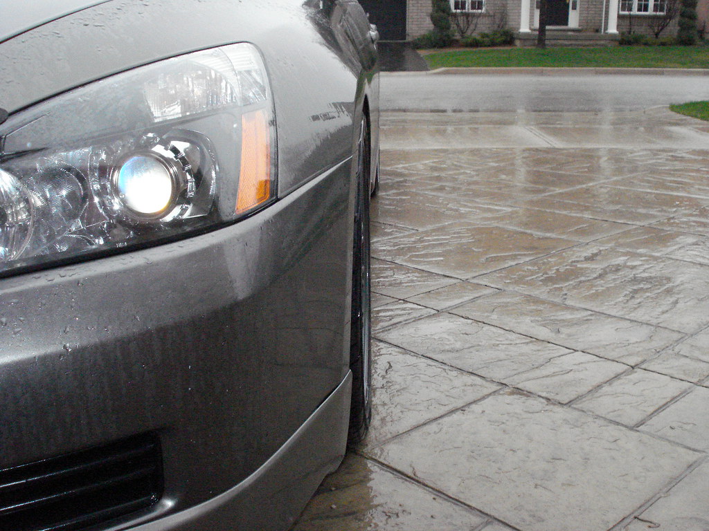

ordered some 225/40 s-drives to be installed on tuesday... hopefully i can handle being 1.5cm lower
