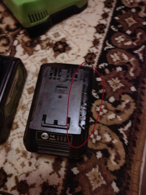

What happens last night was scary for me.
I put greenworks batteries to charger (24V x 4A), wait to hear beep and to take of batteries from charger.
r/Greenworks - Battery explode
But instead of this i hear BUM, i intemedially go to see what happens and i see one of them smoke, i take out charger. Then i go to see bateries and i see that other battery have a liquid.
Because its on side it looks like that this battery have a smoke and look like its other. And i am not sure what to do.
Can i use another battery or is best to throw both? The biggest problem is i am not from USA and shipping is slow. Amazon even dont send batteries to my country (they send some tools with batteries but just bateries not).
Batteries and trimmer are almost new. I use trimmer 4 or 5 times. Usually i trim at morning, charg at night. I am soo shoocked. Are anyone have advice what i can do? I was thinking to contact amazon but they allready back money for this trimmer because delivery was weeks late. So i am not sure if they do anything.
I am most curious why this happens.
Sorry for my non perfect english.

Contact greenworks for advice. That should be a warranty replacement. The other battery is /probably/ fine, but there could've been a factory issue where a whole run of batteries was bad.

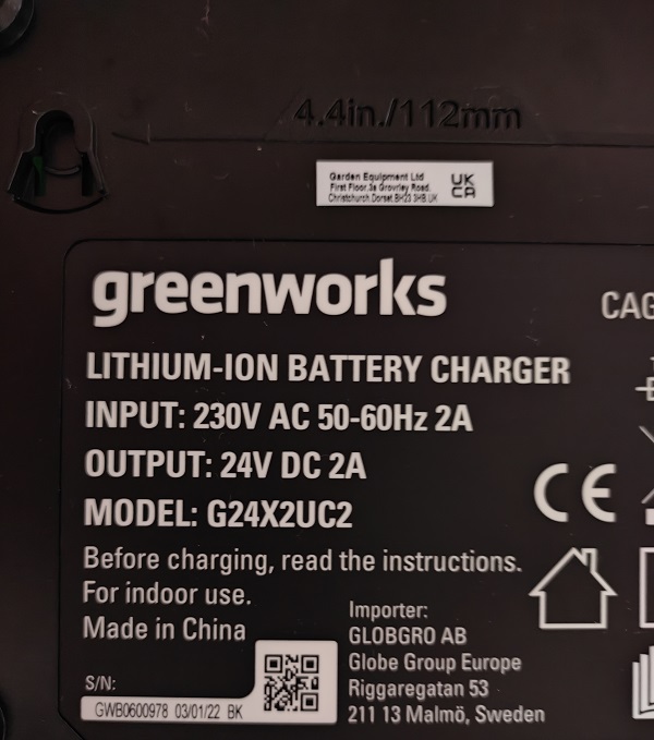

I am not from USA so i cant call them, i send them numerous mails on every mail i find but no answer.
So what i do, i get 2 new batteries and new charger.
New charger i get is: https://www.amazon.de/-/en/dp/B08CKFWCX3/ref=twister_B0CLRY9MD2?_encoding=UTF8&psc=1
But i get numerous problems:
1. Extremely hot, i cant him turn off and wait untill i can get him, but maybe its ok and i understand so lets with
2. Buzzing, this is not ok, when i turn him on i hears litle zzzzzz.
3. Charger too slow, i put him 6 hours and it not even full charge, i must put him in 2 times for 4 hours if i want to charge this.
4. Battery become empty soo fast. Before this charger batteries last about 40min, now its about 10mins, i cant use string trimmer for any serious job now. 5. When i use this charger battery just lose connection with trimmer and it works 1,2min than turn off, than works 2,3 min etc etc.
Are someone have advices? My question is. Are this charger charge every battery on a2 speed on both? So it split on 2, which is 1a when charge? Can this be problem?

Wouldn't it use a switching charger? I thought those were pretty standard on global electronics.
Reactions: stefs12

^ Often yes, universal input voltage range is common, but some opt to save 20 cents when making region specific chargers. Either way, the acceptable input voltage should be on the charger label, probably in the manual as well. If you don't have to adapt the plug to your region's outlets, odds are high it works with that region's voltage.

The pic you posted reads "Before charging, read the instructions". ;) It also reads 230V so we shouldn't have to worry about your mains voltage, assuming your power grid is somewhat stable and in the neighborhood of 220VAC to 240VAC.
