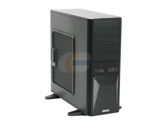

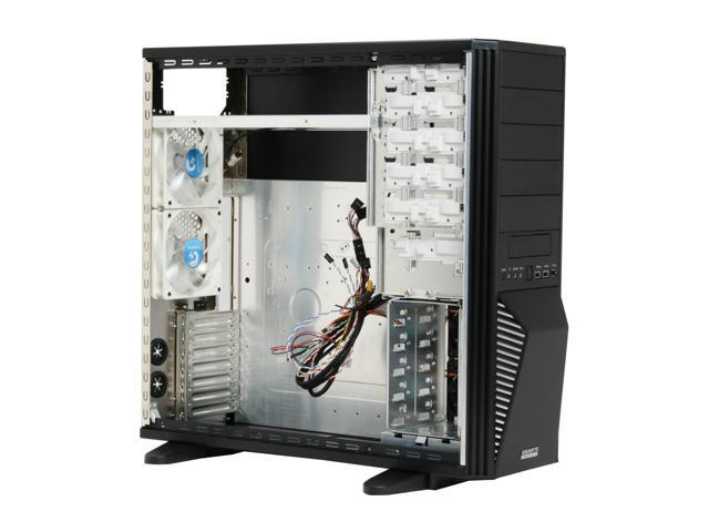

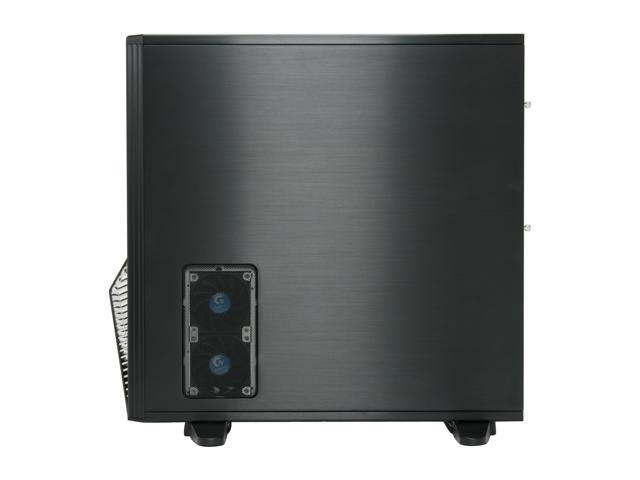

Well with a double 120 rad covering the top two exhaust ports, a single 120 covering the rear port, all that leaves is one front 120mm fan slot open. How can I possibly put in 3 more intake fans? Is the Silverstone TJ09 just not a case apt to watercooling or is there something I'm overlooking? I've resumed my hunt for more WC-friendly cases, what do you guys think about this one?
http://www.newegg.com/Product/...x?Item=N82E16811233026
It has the dual 120mm rear slots which would presumably be great for a dual rad, plus it has a dual 80 or 90mm (can't tell from the pic and it's not listed in the specs) fan setup for the hard drives, but I could put another dual rad there and relocate the drives to other empty bays up above. Here's a pic of that hard drive side fan slot:
http://images10.newegg.com/New...mage/11-233-026-06.jpg
Internal view:
http://images10.newegg.com/New...mage/11-233-026-11.jpg
External:
http://images10.newegg.com/New...mage/11-233-026-02.jpg
edit: are image tags not allowed or something?

I would probably go with a stacker 810 before that gigabyte case. They are one of the most versatile water cooling cases on the market. Only cases I can think of that are more versatile are the Ll343 or MM cube.
