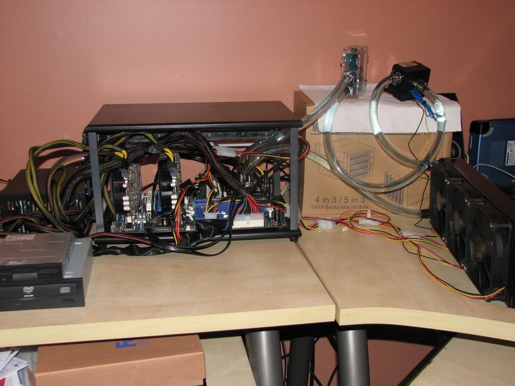

Few things to note:
1) I migrated from Tuniq to Water cooling so tuniq is sitting in a cabinet.
2) Done the vdroop mod on my EVGA 680i so almost no droop.
3) I'm running on an open HSPC Tech Station right now so air flow shouldn't be an issue.
4) I did lap the cpu and tuniq and ended up with the same results. Although not sure I did that great of a job.
5) I had done all the different TIM applying tecniques when I had the tuniq running.

How is the rad mounted? what case? pics?
