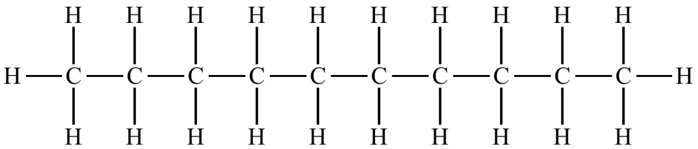

But if you think really wel about the subject, you will find that hydrocarbons are a very good storage of hydrogen.
One wants a high hydrogen to carbon ratio. To increase the amount of available stored hydrogen.
It seems there are aliphatic hydrocarbons and aromatic hydrocarbons.
My guess would be that aliphatic hydrocarbons are favorable because of the high hydrogen to carbon ratio.
Think of Decane for example , which after a quick glance looks good, or at least it seems good. See this Kekule structure.
