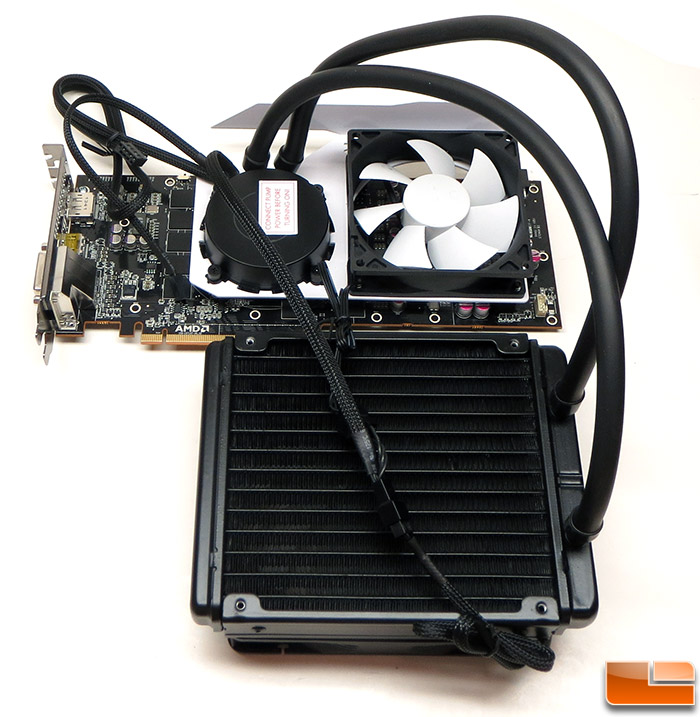

I have the corsair H50, the cheapest AIO available with a Karken G10 and run it with a low noise adapter.
On a cool day I get around 55-60 C while on a hot day (like today, my room temp is 85 F) I maxed out at 68 C.
I'm not sure why people go for H55 or anything else more expensive.
I don't have the reference video cards. I have the Gigabyte Windforce cards with three fans. Will those water coolers still work?
dn7309
Dec 5, 2012
469
I don't have a reference video cards. I have the Gigabyte Windforce. Will those water coolers still work?
The G10 is mounted throughthe four mounting holes around the GPU so I think it would fit since most aftermarket cards share the same 4 holes pattern.

dn7309, thanks that's good to know. Just to double check the H50 can be mounted to a 120 fan slot.
David
the h50 can be mounted into most 120mm fan cut out assuming you don't have clearance issue with the motherboard, hard drive cage or CPU cooler.
the H50 is a very slim AIO radiator

David, I'm telling, you have more chances of screwing with an AIO cooler.
Those coolers are not meant to go on a GPU. On the other end, the blocks do and they are engineered for that. Also, watercooling is hell of a fun.
