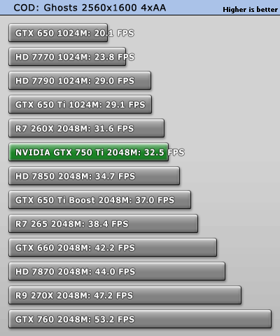

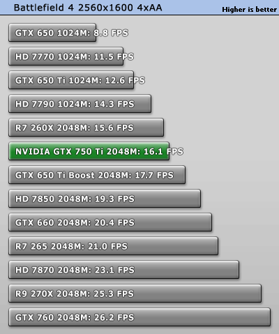

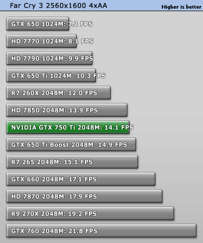

From your link,
Have a look what happens when you enable AA filters at 1080p/1600p
GTX650Ti Boost is ~14% faster
GTX650Ti Boost is ~11% faster
GTX650Ti Boost is ~10% faster
GTX650Ti Boost is ~24% faster
GTX650Ti Boost is ~6% faster
Now, Crysis 3 and Batman is the only games that 750Ti is faster than 650Ti Boost at 1600p 4x AA.

From your link,
Same happen to AMD R9 285, once you enable AA filters, GPUs with fewer ROPs struggle badly. I believe we will see the same behavior with GM204 vs GK110.
There is very intensive games with AA where the GTX 750 Ti is better than 650 Ti Boost too.
Like Crysis 3 where it is 20% faster. Or Tomb Raider where they are equal.
Most of the games the 650 Ti is 10% above in 1600p (which is why it is 10% faster in average) but that isnt because of the bandwidth but because of the cores itself between the two.
