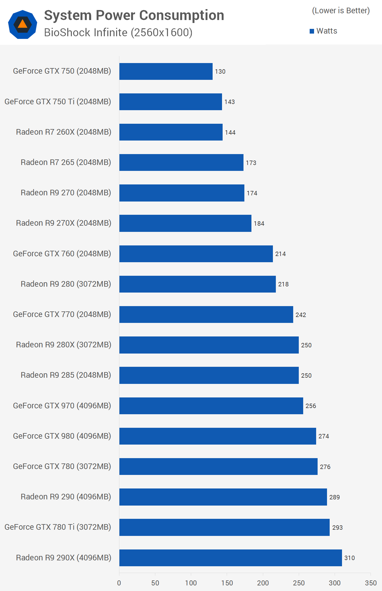

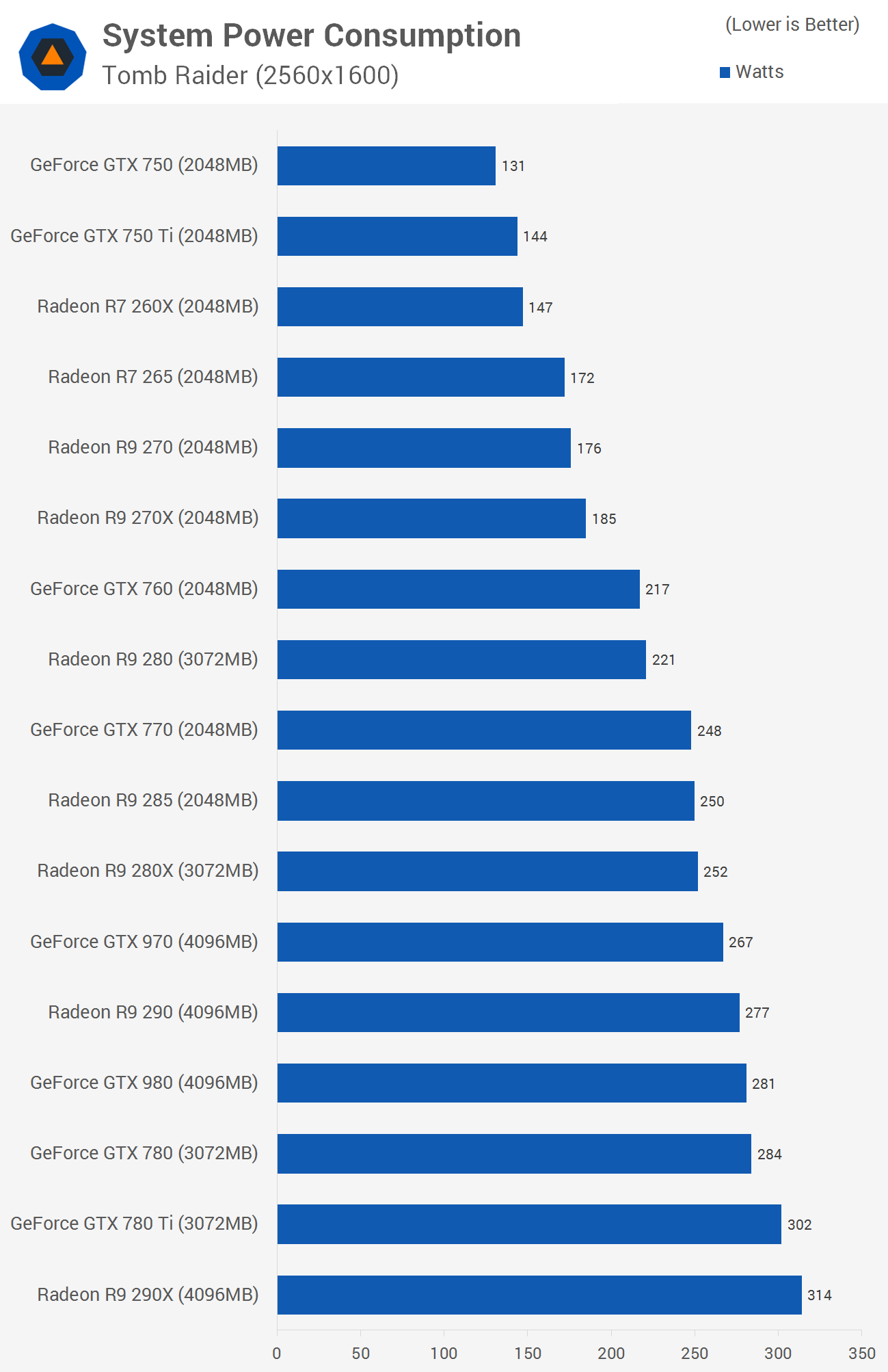

Take for instance perf
GM204 - 1.6 (60% higher perf according to reviews)
GK104 - 1.0
Watt -
GM104 - 0.8 ( I am being generous here as some reviews show GTX 980 drawing same power as GTX 770 while some less than 10% power reduction)
GK104 - 1.00
http://www.techpowerup.com/reviews/NVIDIA/GeForce_GTX_980/24.html
http://www.computerbase.de/2014-09/geforce-gtx-980-970-test-sli-nvidia/12/
http://www.anandtech.com/show/8526/nvidia-geforce-gtx-980-review/21
Area - sq mm
GM104 - 1.35 (398 / 294 sq mm)
GK104 - 1.00
Perf/watt - 1.6 / 0.8 = 2.0
Perf/watt/sq mm - (Perf/watt) / sq mm = 2.0 / 1.35 = 1.48.
So you see when normalized you get the actual improvement which is close to a 50% improvement. I would say this is the actual Maxwell architectural efficiency improvement. This 50% perf improvement is also what we are likely to see between GM204 and GK110. :thumbsup:

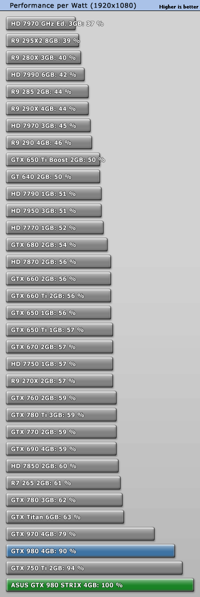

So what are we to do with GM107, when it comes to "actual performance" perf/W/mm2 metric?
GTX 750Ti (GM107)
Perf = 0.55
Watt = 0.3
Area = 0.5
Perf/W/mm2 = 0.55/0.3/0.5 = 3.666
Which makes it 266% improvement over 680.
In what world is GM204 100% downgrade compared to GM107.
Their perf/W is basically the same.
You are normalizing (dividing) twice for size - Watt and mm2.
Yet you and you are accounting for perf only once.
Maybe:
perf^2/(Watt x Area).
That would at least make some sense. Maybe... 🙂

His point is actually very simple. It's really incorrect to say that Maxwell has 2x the perf/watt over Kepler architecture. Why is that? Because 980 on the same node isn't the same size as GK204. If you made a 561mm2 GM210, it wouldn't be 2x faster than 780Ti. Therefore, you would have just disproved the statement above. It's more correct to say that 28nm GM204 has 2x the performance/watt of 28nm GK204 but we can't say anything accurate about GM210 vs. GK110 from that.
But even the statement I made that GM204 is 2x more efficient is a lie. It's more like 60-75%.
980 is not 2x faster than GTX680/770 on average and unless you buy a reference 980, after-market 970/980 cards use way more power than 165W.

How much power does GDDR5 actually consume? Considering those chips are mostly passively cooled without an actual heatsink, I'd assume the GPU itself consumes (and displaces) most of the wattage required for a card.
How much is the lower power consumption from the cut back memory system and/or from rearranged smm config on maxwell? because the power difference isnt that great from a 780ti or 290x.
Die size can obviously be a factor in perf/W. Let's create an example where you have two chips, one 250mm2 and one 500mm2. For the sake of simplicity let's assume that the larger chip is exactly twice the smaller one, and also assume linear scaling. At the same clockspeed the 500mm2 chip is twice as fast as the 250mm2 chip. Halve the clockspeed of the 500mm2 chip and it's around around the same performance as the 250mm2 one, but the 500mm2 chip has far better perf/W because the lower clockspeed allows it to run at a far lower voltage, which is the most important adjustable factor in determining power consumption.
Basically, if you have twice the transistors doing twice the work at the same clock speed and voltage you'll have more or less 2x performance (assuming good scaling) and 2x the power consumption. If you have twice the transistors doing a bit less than twice the work, at a lower clockspeed, and at a lower voltage you'll have less than 2x performance, but better perf/w.
That said, GM204 runs at a higher clockspeed than GK104, and isn't close to a 250/300W thermal limit. Die size probably isn't much of a factor as theoretical +/-100mm2 derivatives will likely run at the same (or at least at a similar) voltage.
If those graphs are accurate the perf/watt improvement is the score difference with the 780TI in % to wich we can add a handfull watts better comsumption, this shouldnt be more than 30% overall.
