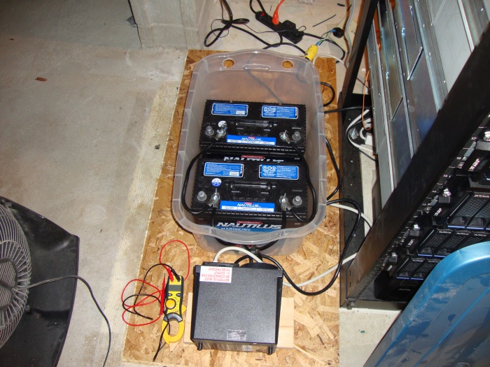

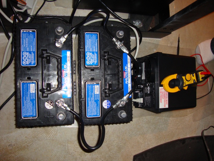

Wow forgot about this post. I actually ended up buying an inverter-charger which is designed for this. Safer.
And according to my research the APCs are known to overcharge even their proper SLA batteries. (that's why they only last a few years).
I also have a hydrogen sensor on the way, for safety's sake. But since this is a standby system I don't think there will be enough hydrogen produced to be dangerous. That stuff dissipates faster than fans at a Soccer game shootout.
Also debating on getting 2 more batteries. 4 hour run time is nice, 8 hour would be even nicer. :D Most of the power outages last a few hours at most though. I did see some as long as 4 hours. It's a summer thing, because of all the construction in my area and the occasional storm.
