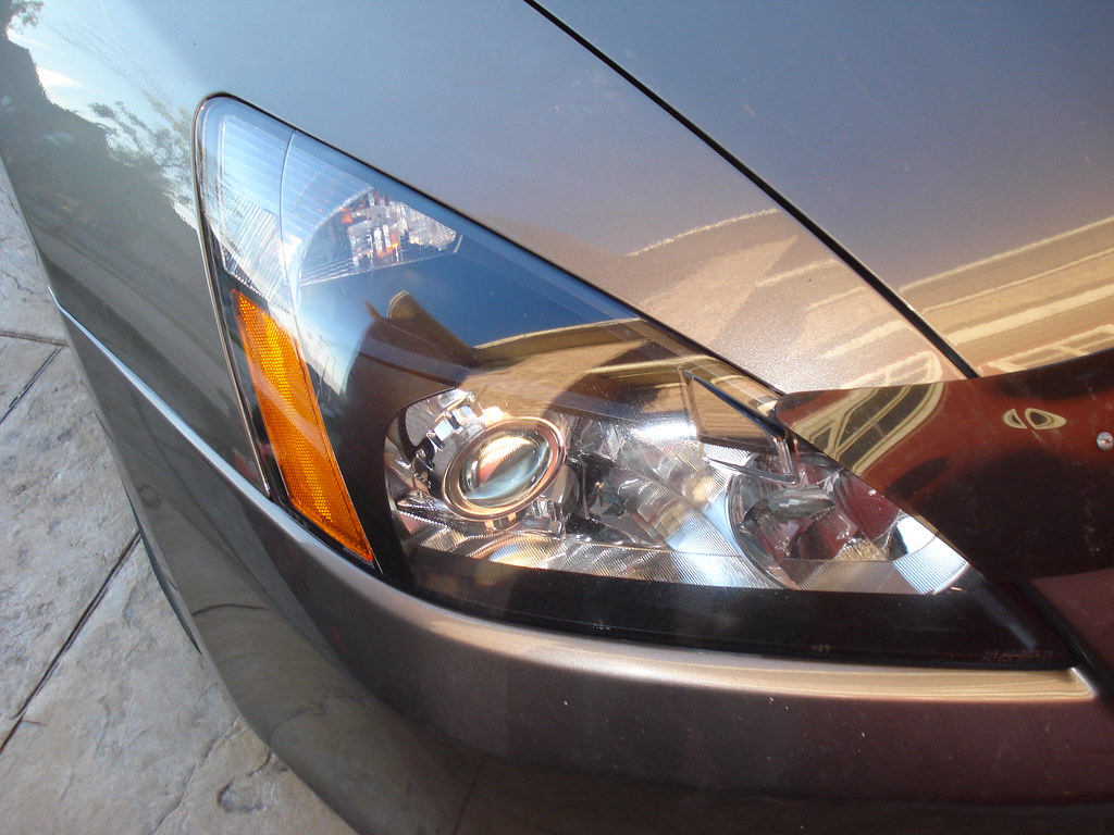

real HID projector retrofit into stock housing ftw. i plan on putting s2k projectors / HIDs in my Si when time and money permit.
should look something like this:
