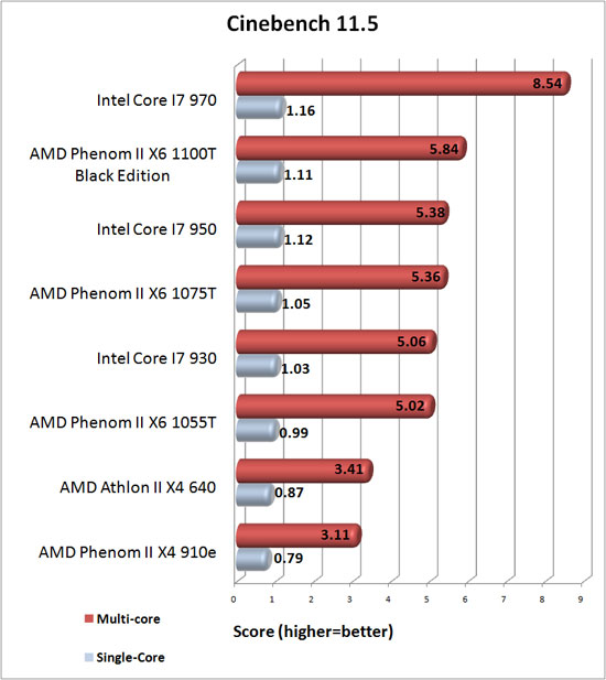

As I've already told you, the Westmere CPU's do work with your board. They came out after the board was made, but work fine. Anyway, looks like you're got it working better. There's no reason not to enable turbo, by the way.
No way you'd have been better off with the i7 950. It scores 5.38 in Cinebench 11.5. You're already faster than an i7 970..
I enabled Turbo and it crashed Cinebench. Same when I set Turbo on auto. So went bad and disabled Turbo and it no longer crashes Cinebench. BTW I also ran Photoshop and did some time consuming rendering without a glitch while Turbo was disabled. Perhaps some other setting also needs to be changed?
Somewhere 12 pts score on Cinebench was mentioned and that is why I was not happy with 10.20 pts. Perhaps I should be?
The 950 video showed it easily going up to 4.10 MHz. If I remember correctly. This is why I said that I may have been better off staying with the 950.
EDIT: ooops. I forgot that I got 4 more cores in the W3960. So yes I am glad I made the upgrade.
