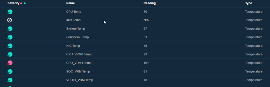

Not an expert but how about stacking extra heatsinks on top of existing ones with thermal paste in between?dowcnlocked speed to 2.3 due to vrm temps. I need bigger vrm heatsinks, can't find them.
well, I can say that the existing heatsinks are a joke for a 500 watt CPU. I need to somehow increase their size or effectiveness.Not an expert but how about stacking extra heatsinks on top of existing ones with thermal paste in between?
Anyone else who knows better should jump in before Markfw takes my bad advice 🙂

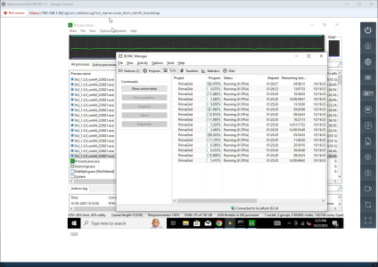

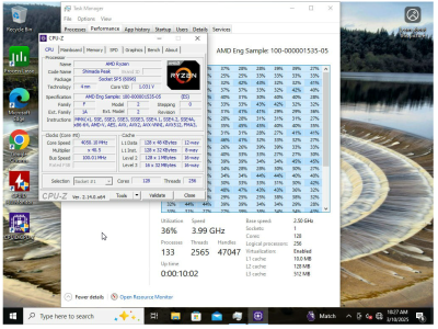

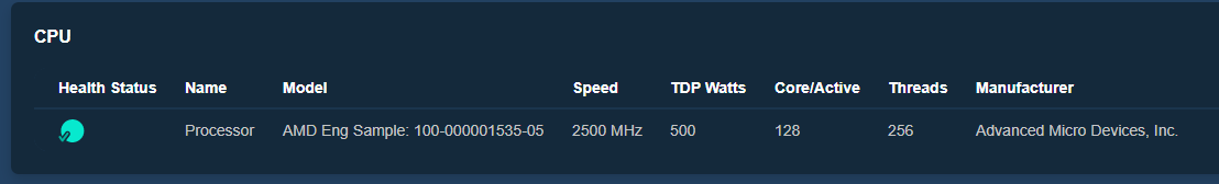

They rarely go over 370 watt or so, except when fully utilized on all cores with very heavy avx-512 code running, THEN they hit 480 watts or so @2.7 ghz.
Do you recall what the average core clocks were with WCG Mapping Cancer Markers? (Or if not, would be nice if you could look this up after the PG challenge.)the 1245-08 is ES, the 1535-05 is a QS, should be the same as production/retail. If I load 256 jobs of WCG , it uses 370 watts on kill-a-watt. With 128 cores load with no SMT and heavy avx-512 (primegrid) it uses 480.
