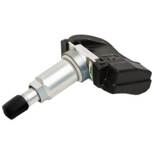

You need a special tool for that. Something like this.
And of course the programable sensors.
This set has 8 sensors
Sensors are fragile so having a shop do it is a safer bet.
