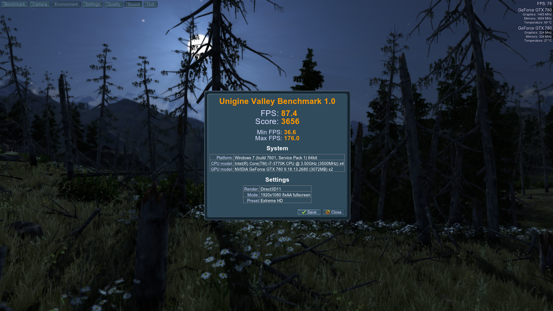

Hi gyus this is my first post here sooo nice to meet you.Gyus I have big broblem here. first score on valley I take score 143.1 frames with 1201 core and 3641 memory and 1.21 voltage on air.Now with same system same windows.1291 core and 3804 memory and 1.30v on water I cant reach tha same score every time that I run valley my score is under 143 score with any overclock on core or memory.Realy strange I cant find the reason probably I have to format my pc.edit In two cases I have tha same bios.Yesterday i run the same clocks like first time 1201 core 3641 memory and the frames are still low 130.4
