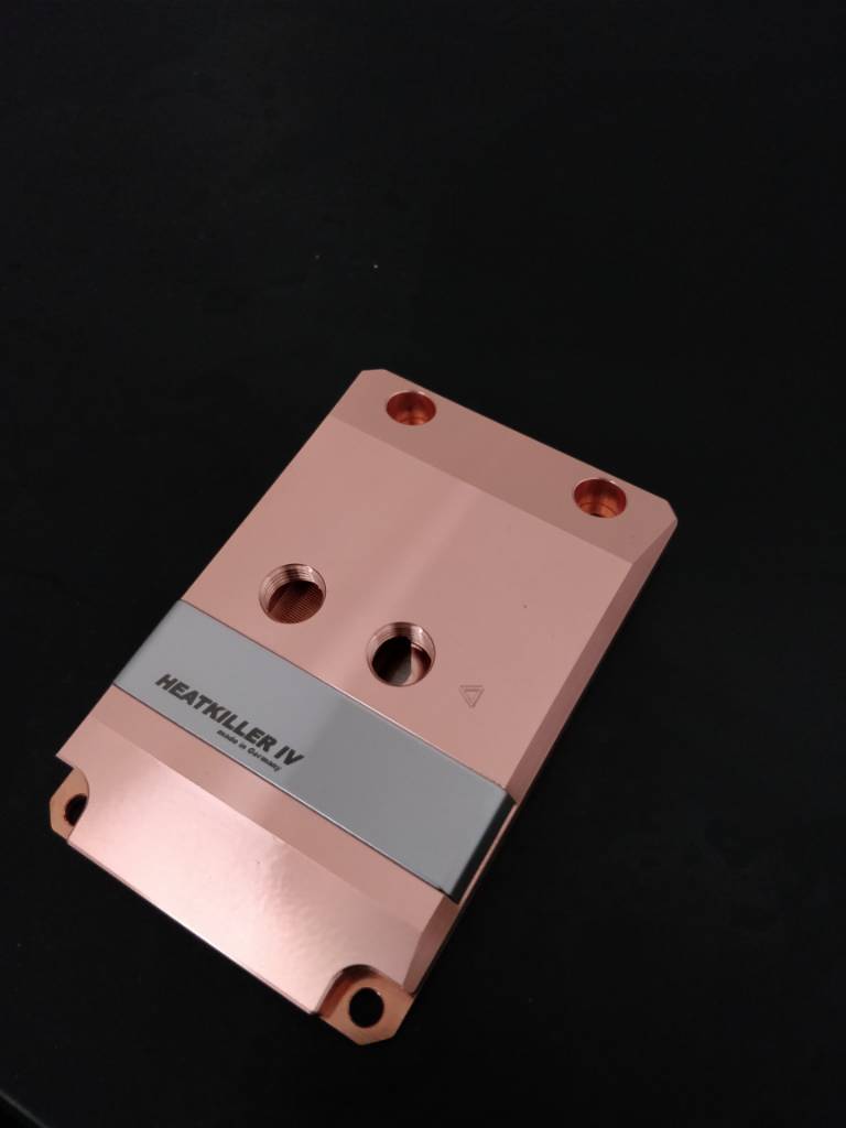

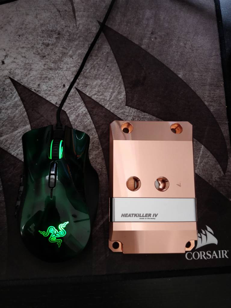

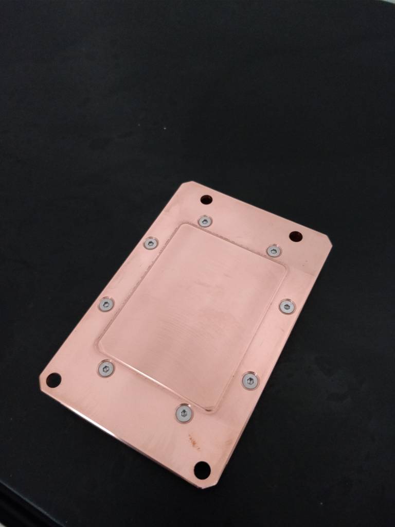

My heatkiller TR copper block came in today and this block is the heaviest block I have ever got. 2.2lbs to be exact according to the heatkiller rep. It's just ridiculous!! Some pics and a pic next to my mouse just to put things into context.

Yeah, I was a little surprised at the orientation as well. They are still waiting to get a photographer to update their website. Really curious to see what kind of temp drops I see with this.
