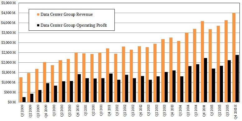

In terms of where the money is going. We all know mobile and server is the key areas. But this one shows the visual part of the server segment.
In 2016 cloud alone is forecasted be twice of what it was in 2013.
http://www.nextplatform.com/2015/12/10/looking-ahead-in-the-datacenter-with-intel/
