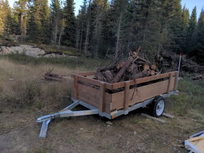

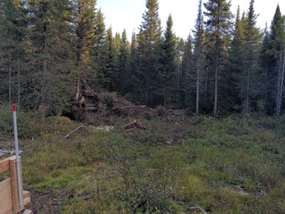

I put the trailer to the test today, it survived the highway and gravel road and also survived a mostly full wood load. I will need a lot of practice backing it up though, but it's my first time actually owning a trailer or really using one. This will go well to clear that pile that's in the background though, was doing it by hand back and forth and it was hard on the feet now I can just load the trailer and then pull it closer to burn pile and separate into fire wood and immediate burn wood.

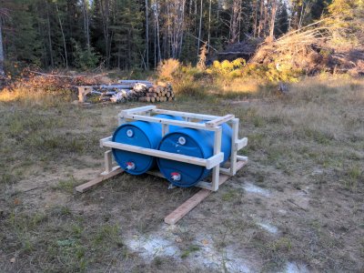

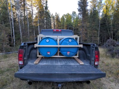

Fairly crude redneck construction, but made a frame for 2 55 gal barrels to hold them still for transport. End goal is to plumb them together so there is a single fill port and a single supply port, and a vent. There will also be a battery pump to pump the water out and a battery submersible pump to pump water in from a lake, and it will be all self contained. Although the pumps will need to be easily detachable so they can be stored inside so the residual water does not freeze overnight.
For now though they are just stand alone tanks, doing lot of brush cutting tomorrow and will have a fire going so I want this ready just in case, and also to put the fire out after. I just brought it home and filled it with town water. I may modify the side section so it's a single 2x4 instead of the 2 small ones. I was trying to find ways to save on weight, but in grand scheme of things it's pretty negligible and will be stronger if I redo that part.

Yeah hopefully it will be fine but will need to drive carefully. I might add some metal nail ties in key areas to strengthen it. Like L brackets at the middle corners, that middle 2x4 is what's going to be taking on the most abuse during accelerate or decelerate events. It's definitely something I already have plans on modifying.

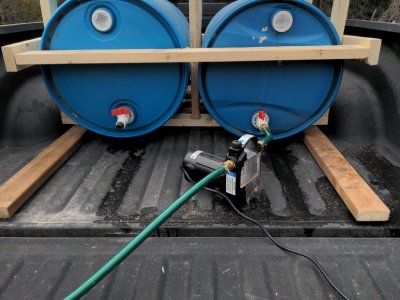

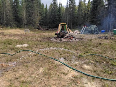

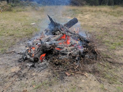

The water transportation setup worked out well but I do need to make a few changes such as reinforcements. It was fine in transit, but I can tell the front and back supports are the weak spot when man handling it, making the side continuous will fix that. Also need to take out some material on the bottom side rails, it fits too snugly in the wheel wells making it too hard to move after. May also need a straight piece to better support the bottom of the barrel, I don't think they're really meant to be filled up and suspended that way, they were buckling a bit.
Also did not realize just how fast my 1/2 hp pump could empty one barrel, If I were fire fighting this would hardly be enough unless I'm just putting out embers. Definitely something to think about when I get more established and want water storage for fire fighting so I don't end up like that town that had no working hydrants and burnt to the ground. Whoops.

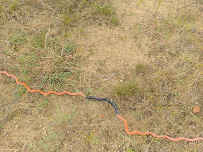

To add some excitement to all of this I was using a super sketchy extension cord that was given to me. I realized that the good cord I brought up here is only 2 prong.
