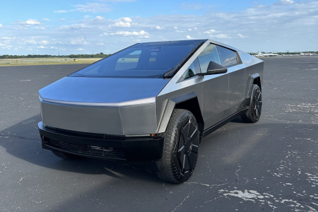

My 2 cents is that the Cybertruck is amazing tech a decade ahead of its time in horrendous and hideous packaging.
As someone that lives where they salt roads heavily for the half of the year that it snows, and has seen every car my family has owned rust away, that "hideous" part is gloriously beautiful because it's Stainless Steel that won't rust away.
I hope it's a massive success because I want more Stainless Steel cars.
