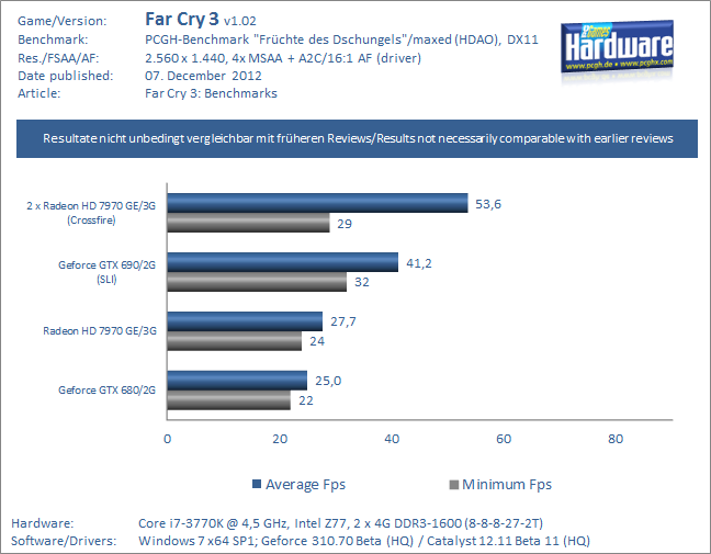

PCGames hardware posted new videos of Far Cry 3 to test micro-stutter
Far Cry 3 - GTX690 SLI vs. HD7970 GE CF
GTX690 SLI video as a gamer would see it on his monitor:
http://www.youtube.com/watch?feature=player_embedded&v=YaCbI8nx8Fo
HD7970 CF video as a gamer would see it on his monitor:
http://www.youtube.com/watch?feature=player_embedded&v=WXi_ra7Zr14
GTX690 SLI stutters more, unlike HardOCP's conclusion. Here are the 2 videos combined into slow motion (on the top left you can select HDD ON if it doesn't do it automatically):
http://videos.pcgameshardware.de/hdvideo/12558/Far-Cry-3-Mikroruckeln-in-Slow-Motion
How come SLI stuttered more in PCGamesHardware testing? You can't expect reviewers to test the same sections of a 20 hour game. Depending on where the game is tested, you can get different results. Just like we need to see 10-20 GPU reviews for FPS, now we are going to need 10-20 websites to make videos of all these games to draw more statistically accurate conclusions.
The only reason the Geforce cards appear to stutter in that comparison is because they are running at an FPS below the monitor's refresh rate while the AMD setup is not. This is the conclusion the reviewers themselves came up with, as shown in the german text next to each video.
There is a specific issue at hand, seemingly caused by the latest betas that is causing frame latency issues on AMD hardware, and this isn't it.
Ya and so do AMD's 7970GE cards because they don't even come close to 60 fps either. The main reason the 680s are stuttering even more than 7970s in that video is because they are running even slower in that area of the map than 7970s.
