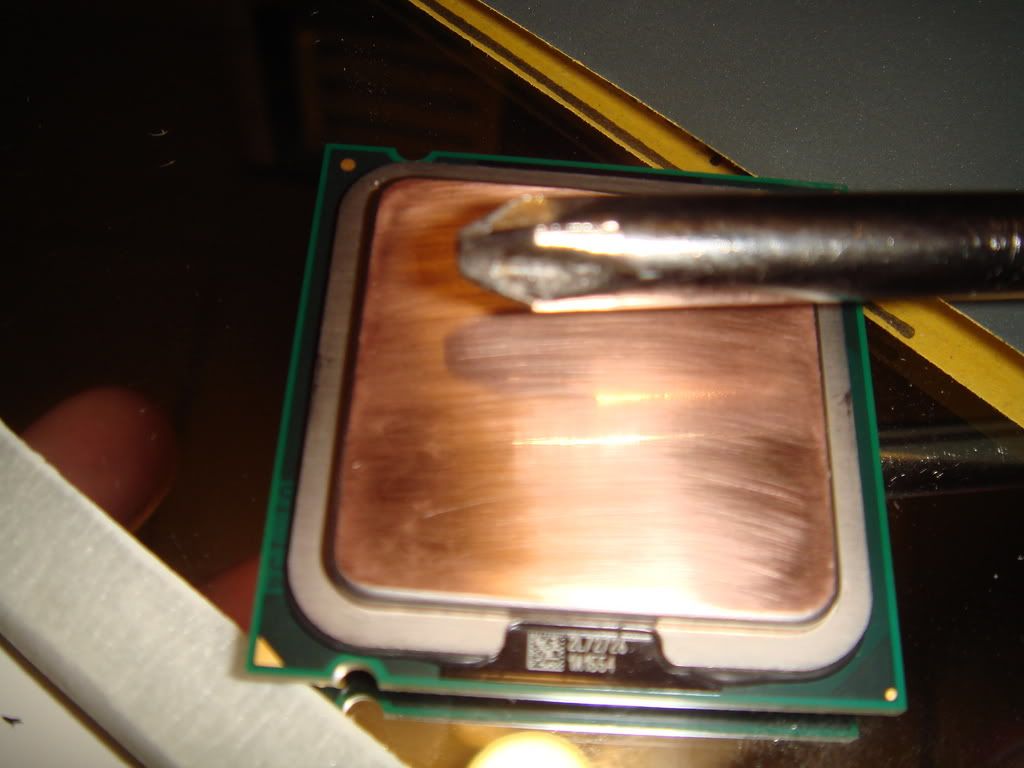

Before lapping
I wish i would have known that 3 days ago. But, I was board tonight and figured now is the best time. I also bought a new 250 caviar to place XP on. then duel boot to Vista 64. Anyways, It was a good time to lap. Here is a few pics of what I have now.
Before lapping

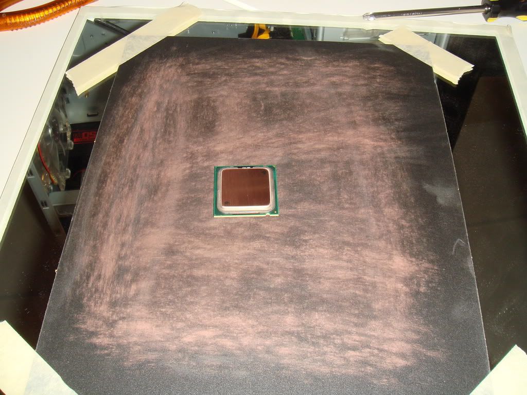

After 10 minutes @ 400 grit.
Just realized the blur, I will try and fix that for the next few photos.

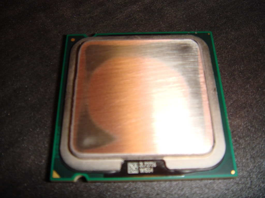

After 10 minutes of 800 grit
The actual working sand paper, 800 grit.

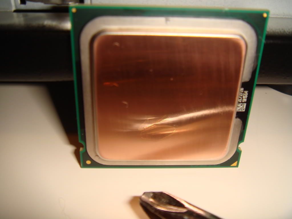

after 10 minutes of 1000 grit. Note: there is a bit of reflection now.
The Screwdriver is there for reference only.

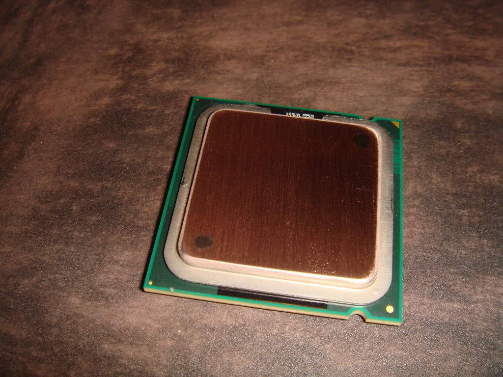

After 10 minutes of 1500 grit. We are finished.
Note:I gave my Heatsink a quik once over with 1500 grit to smooth it out as it was very level.

Before lapping

OK, Its all done, CPU is back in the box, and Picture of my desktop coming in less then 5 minutes, Temps have gone down about 4c

EDIT: I just put my CPU back to original OC andits official, my temps dropped about 6c.
