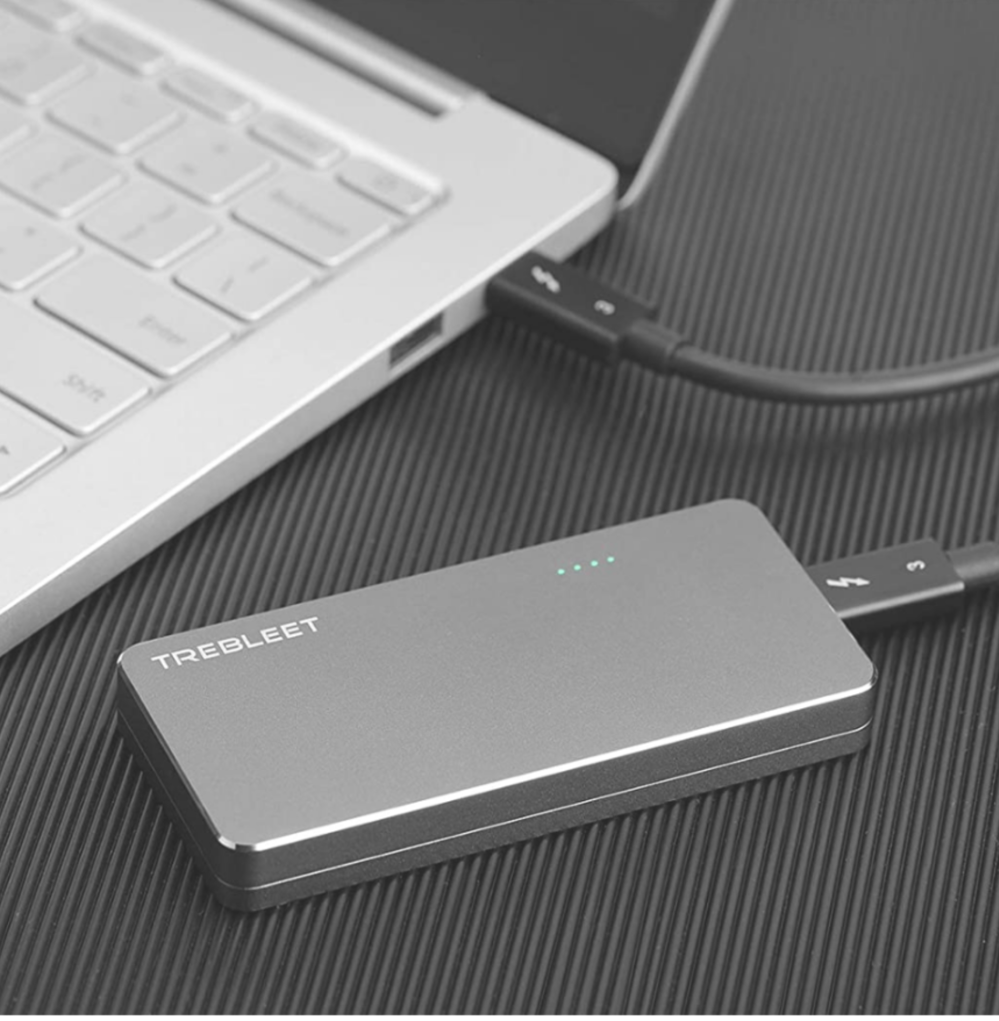

So I went ahead and got the Thunderbolt 3 enclosure, and so far everything is working fine with a WD SN750 Black, 2tb. I've got windows installed, performed updates, added all my families login accounts, and installed a bunch of apps. Speeds are around 2600 read and write. Enclosure gets a little warm, but so far I haven't noticed any throttling.
Only issue I had was Boot camp wasn't installing the drivers, it would go through the motions but non were actually installed. Had to do them one by one. Will update if issues arise.
TREBLEET Thunderbolt 3 SSD Enclosure,Thunderbolt3 to NVME M.2 2280 Hard Drive Case https://www.amazon.com/dp/B07N67P39W/ref=cm_sw_r_sms_apa_i_8vlWEbX1N7VTS
Sent from my Pixel 4 using Tapatalk
An update, this enclosure is working great, temps are high 40's, no throttling, and everything in Windows 10 is working fine, system even goes to sleep overnight and next day wakes up with a move of the mouse. You can't even tell it's an external enclosure, works just as good as the internal drive with MacOs.
Was a bit expensive, but highly recommend if you have an iMac and thunderbolt 3 connections.
