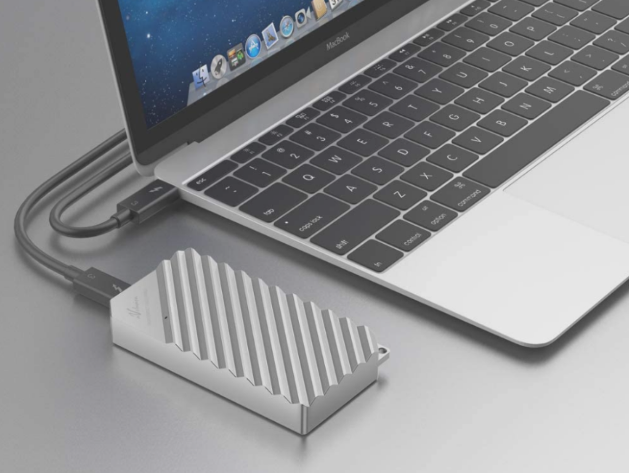

Has anyone tried this enclosure? According to one of the reviews, it states that this actually showed his 970 evo plus and allowed him to use Samsung software.
ineo M.2 NVMe (PCIe) SSD USB 3.2 Gen 2 Type C Tool-Less Enclosure [C2575 M2 NVMe] https://www.amazon.com/dp/B07MZNRGK6/ref=cm_sw_r_other_apa_i_9A9SEbW1M283X

I was going to joke about what the circle bands are for, but it outjoked me. It holds the heatsink in place.
Unless it's dirt cheap, I would move on from that one. I doubt it'll get any after sale support such as firmware updates.
