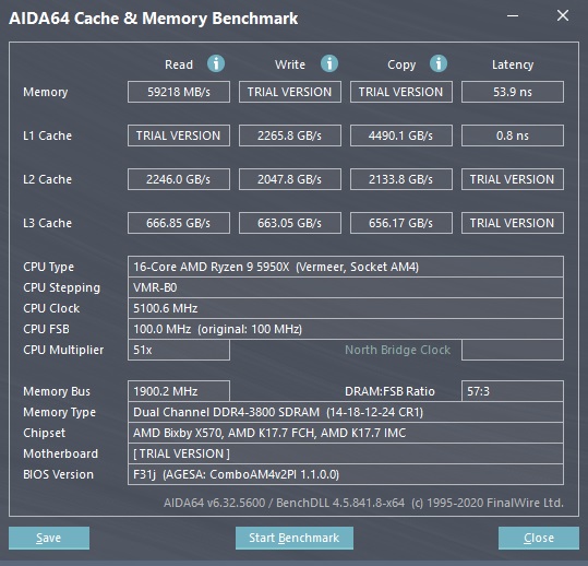

If you can get the L1 (data) to, say, 512KB via stacking, first thing you're looking at is a massive performance increase, and the second thing is that L2 stops making sense as a bridge between L1 and L3 and you can drop an entire level of the cache hierarchy.
Are they going to be able to stack L1 and keep latency as low and bandwidth as high as in existing implementations? Here's a sample of Zen3 in Aida64 (credit to jesdals on the techpowerup forums):
A more complete run with updated AGESA which provides more stable and reliable L3 cache figures in AIDA64 (1.2.0.2)
Bandwidth isn't that much lower than L1, it's entirely the latency that is over an order of magnitude worse and I imagine will be the real hurdle to stacking L1.
L3 latency depend on cpu clockspeed, L1 latency does not.
Also Aida64 is a pretty bad program to measure "real" memory performance in..
Lately some of us have been using Linpack Xtreme to compare real performance as it does a much better job.. Any very few can show real scaling above 1900 flck, but that is a other topic for a other thread :)
(no scaling in other real benchmarks eventho some are rocking 50ns memory latency in aida with fclk above 2100+ and no WHEA errors)
Why Linpack?
It's as close to a "real-world" memory test as any benchmark gets, it will hammer the memory controller AND the CPU so the CCD portion of the infinity-fabric gets hot, uses fairly representative memory in it's "Standard" benchmark (3Gb of heavy IO is about typical for most games/computational-software) and is multi-threaded. The problem with Aida64 bandwidth and latency tests is they put absolutely zero strain on the memory controller, Geekbench is too short and too synthetic, and y-cruncher is a fair substitute but is far heavier than any real-world use-case and so only really useful for scoring HWBot points or really proving a point about stability.
Yes.
In this current implementation, as relayed to Ian on his YouTube channel by AMD, latency is supposed to remain the same (you can round the extra travel distance in the z plane down to 0). AMD is claiming that they're getting 2 TB/s throughput via interleaving, which is a big jump.
The (main) reason why L1 needs to be small is to minimize wire length which in turn minimizes latency. Stacking lets you multiply the area devoted to cache without (in practical terms) increasing wire length.
aida1900mhzv1-jpg.179632
There is not reason to do that though. In future designs of the Zen architecture, the whole of L3$ can be on a vertical stacked die, freeing up more space for larger cores (including L1$ & L2$) or for adding more cores.
Bandwidth is 2-3x higher for the L1. And yes I would be worried about wire length and latency.
