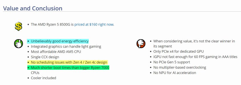

Asterox
May 15, 2012
1,062
1,876
It was about time, that someone finally did a classic detailed test on Windows.
Blue, i don't remember the last time we saw that prominent detail in any another CPU test. But that's to be expected, and of course it matches the Phoronix test on Linux.
Green, that's why we need detailed tests. Very interesting, considering that this is the first time I'm hearing about that detail.
Application Performance
"With this review we're introducing our new 2024 CPU Test Suite, which runs the newest versions of our apps and includes new workloads, mostly for AI-related tasks, which are becoming more and more important every day. Averaged over these 49 tests, the Ryzen 5 8500G offers performance roughly matching the higher positioned Ryzen 7 5700G. It's also able to outperform the Intel 12400F by a small margin—a very important win. AMD's AM5 Ryzen 7000 "Raphael" CPUs are considerably faster though, the Ryzen 5 7600 is 20% faster in applications. Compared to older Socket AM4 processors, the Ryzen 5 8500G sits roughly between the Ryzen 5 5600X and the Ryzen 7 5700X. Overall, this is very respectable performance, especially for such an affordable processor that's targeted at lighter tasks like office, productivity and internet browsing.
Power Consumption
The Phoenix 2 chip design used on the Ryzen 5 8500G was originally designed for thin and light laptops where energy-efficient operation is one of the most important capabilities. On top of that, AMD is fabricating their chip using TSMC's 4 nanometer node and it's a monolithic design, which further helps with power usage, because there's no IO die that's off-silicon that you need to push data over long distances, which is an energy-hungry task. The result is that Ryzen 5 8500G is the most power-efficient processor we've ever tested—by a big margin in many tests. Even when loaded with demanding tasks its power usage will stay at under 40 W, gaming with a discrete GPU is actually closer to just 20 W. Gaming with integrated GPU reaches between 20 and 40 W, depending on the game. Very impressive numbers, only the Intel 12100F can get somewhat close to these results and everything else is much higher. For our 2024 Test Suite upgrade we've added full system idle power measurements, which are very important, because many PCs spend most of their life in that state. Here the 8500G sits roughly in the middle of the pack with 64 W, which is just a few W more than competing Intel setups, but considerably lower than the "big" Ryzen 7000 CPUs, which reach around 80 W, because they have to power the IO die as well."
Reactions: Tlh97
