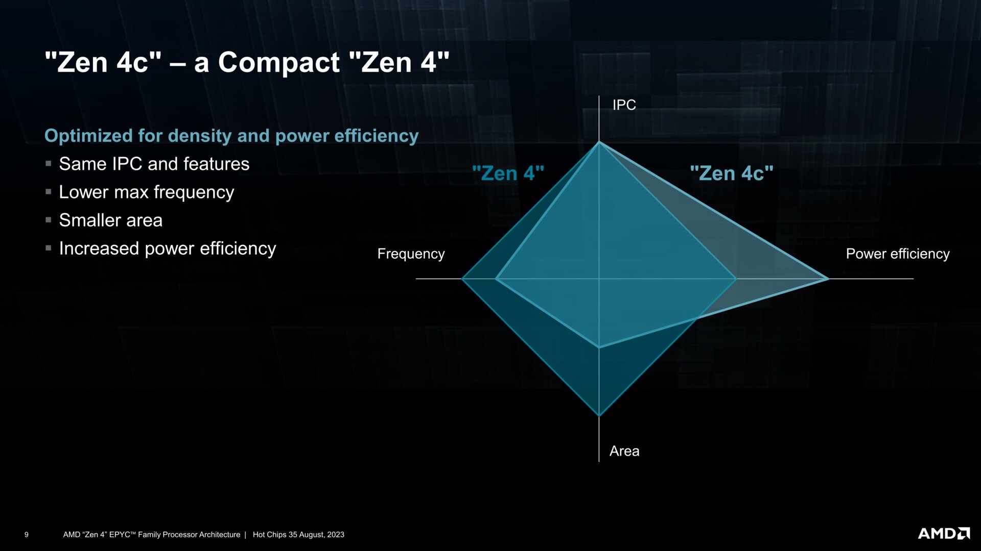

Are there any estimates at how their efficiency compares in server clocks region? While AMD surely can make Z4 use 20-30W per core, i doubt Z4C vs Z4 is that different when both are clocked say 3Ghz ? Not having full P cores is also opportunity cost due to lost peak perf in less TDP restricted regime. 2+4 just feel strange with this floorplan.
On topic of power saving i doubt they can touch Intel's approach of having E-cores outside of main chiplet. In AMD's case performance will be better ( the race to sleep part of "efficiency" ), but power draw due to uncore will be too.
The v/f curve will likely be much different. You won’t be able to get “Zen4c” cores into 4ghz territory at all. They will be extremely efficient at the frequencies they do operate at. However, efficiency isn’t the reason AMD is including them, and I suspect we won’t see any hybrid “enthusiast” class chips…those will be all “big” cores. This is about competing with Intel Core i3/Core 3/Whatever Intel calls their chips these days. Maybe Core i5.
They surely can clock way higher than 4GHz, and likely close to 5GHz, even if this pic is not correctly scaled it s obvious that they lose much less in frequency than what they gain in efficency :

BorisTheBlade82
May 1, 2020
722
1,149
Density, performance, power. Pick 2.
If AMD could have designed the dense cores without compromise, none-dense cores would not exist.
3.0-3.5 ghz is going to be the sweet spot for these chips.
Sure, but as per this review it is "pick one": Density.
So I am hoping this v/f curve is not the real thing as @Abwx suggested.

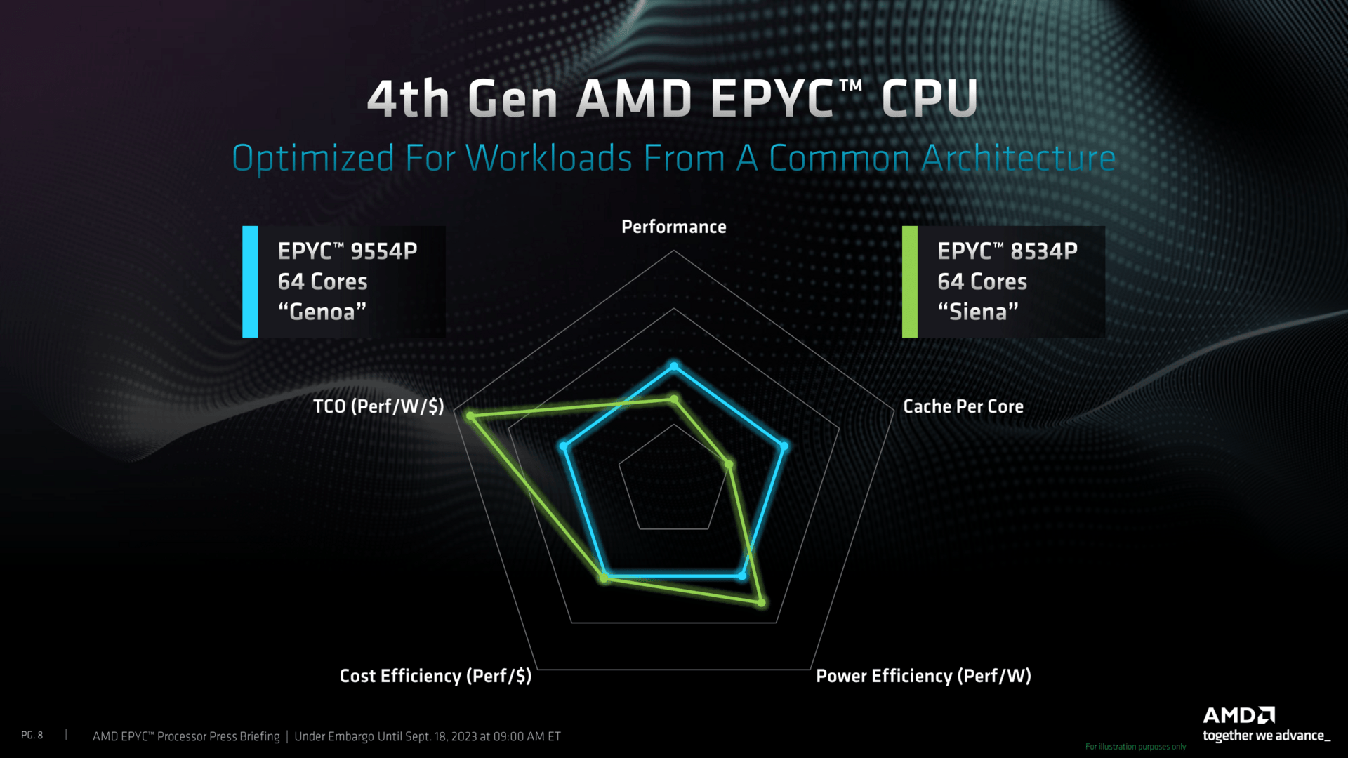

Mainstream "low cost" Epyc SKUs on sight :
Interesting, so Sienna is actually only using Zen 4c cores.
Guess that this allow a full set of advantages, competitively wise that s a no brainer.
The full slide deck can be found here, numbers are telling in matter of perf, perf/watt and cost advantage against Intel :

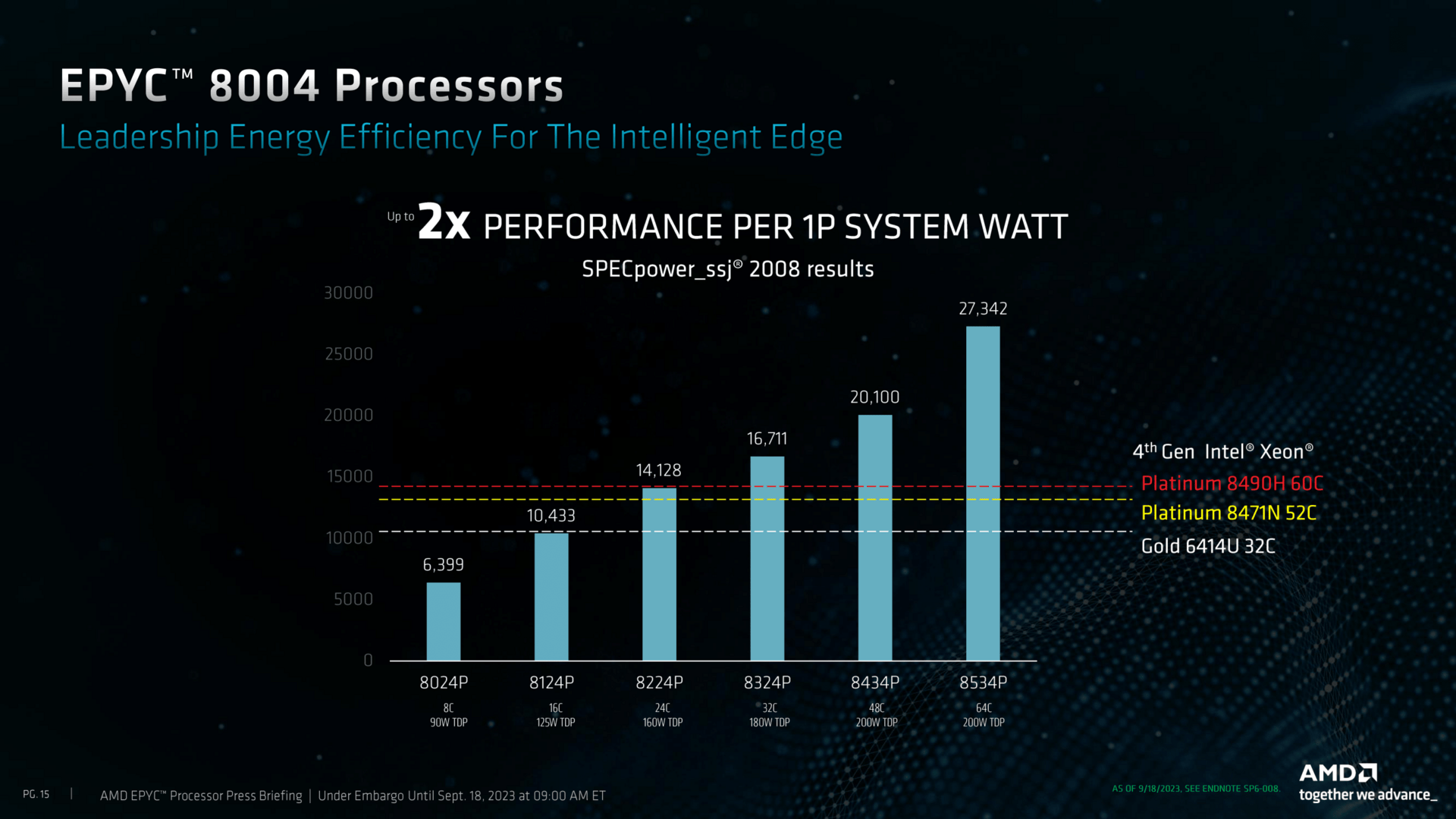

JoeRambo
Jun 13, 2013
1,814
2,105
Bergamo is limited by the sheer amount of cores and a 350W TDP.
As 8004 series has shown us, the V/F curve of PHX2 might have been true. No matter the TDP, even 32C cores are not clocked above 3Ghz. They have like 2x watts per core headroom vs Bergamo, yet stay on 3Ghz max.
Even more is given away by base/boost clocks, not really going anywhere with increasing watts per core.
So pretty much the sweet spot is ~2.6Ghz and not only Zen4C can't clock 4-5Ghz like You've claimed above, it is not really efficient above 3Ghz either.
