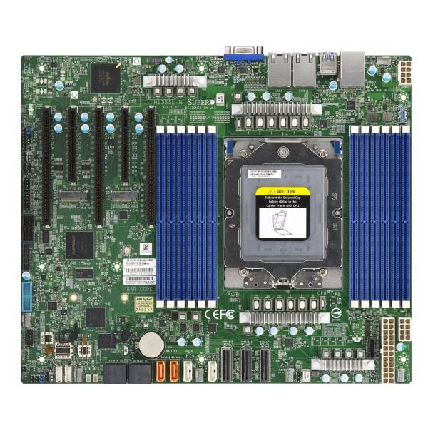

My next motherboard:
So, I got the motherboard and a 9654 and memory. Now to find a heatsink. That is getting to be a problem. But I will reply back when done in case you want benchmarks, if I can. I think it will be linux, I might try win 10 pro for testing.

BTW, anybody know for sure that this memory will run on Genoa ? I know its Rdimm and DDR5 4800 is in spec, but....
Micron MTC10F1084S1RC48BA1R MIZ 16GB 288pin PC5-38400 DDR5-4800 CL40 1Rx8 1.1V ECC RDIMM Bulk

I already ordered 192 gig of Micron MTC10F1084S1RC48BA1R MIZ 16GB 288pin PC5-38400 DDR5-4800 CL40 1Rx8 1.1V ECC RDIMM Bulk, so I will use that. Should be in spec.
I am finding it hard to find parts for this system, as most are probably supported by OEMS.

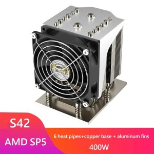

Well, being almost deaf, I can't tell you on the deltas. BUT, the socket is 400 watt, and it uses at least 320, and the heatsinks I could find are anemic, so having delta fans does not surprise me. I think I finally got a good HSF, but it took some doing, and I don't have it yet. The one I have is a 80mm 8000 rpm (delta ??) This is what I am trying to get, I have an order, but they say they can't guarantee I get it ???? And this would not fit in those servers. servers don't need to be quiet, they are in a loud server room (just the AC is almost deafening, from when I could hear)
A///
Feb 24, 2017
4,351
3,160
Deltas are loud, but louder in unison. I buy up old used deltas every so often during dc sales and rewire them to use as a bbq blower. Better than standing next to the fire poking it to keep it lit and feeling like I'm cooking.
