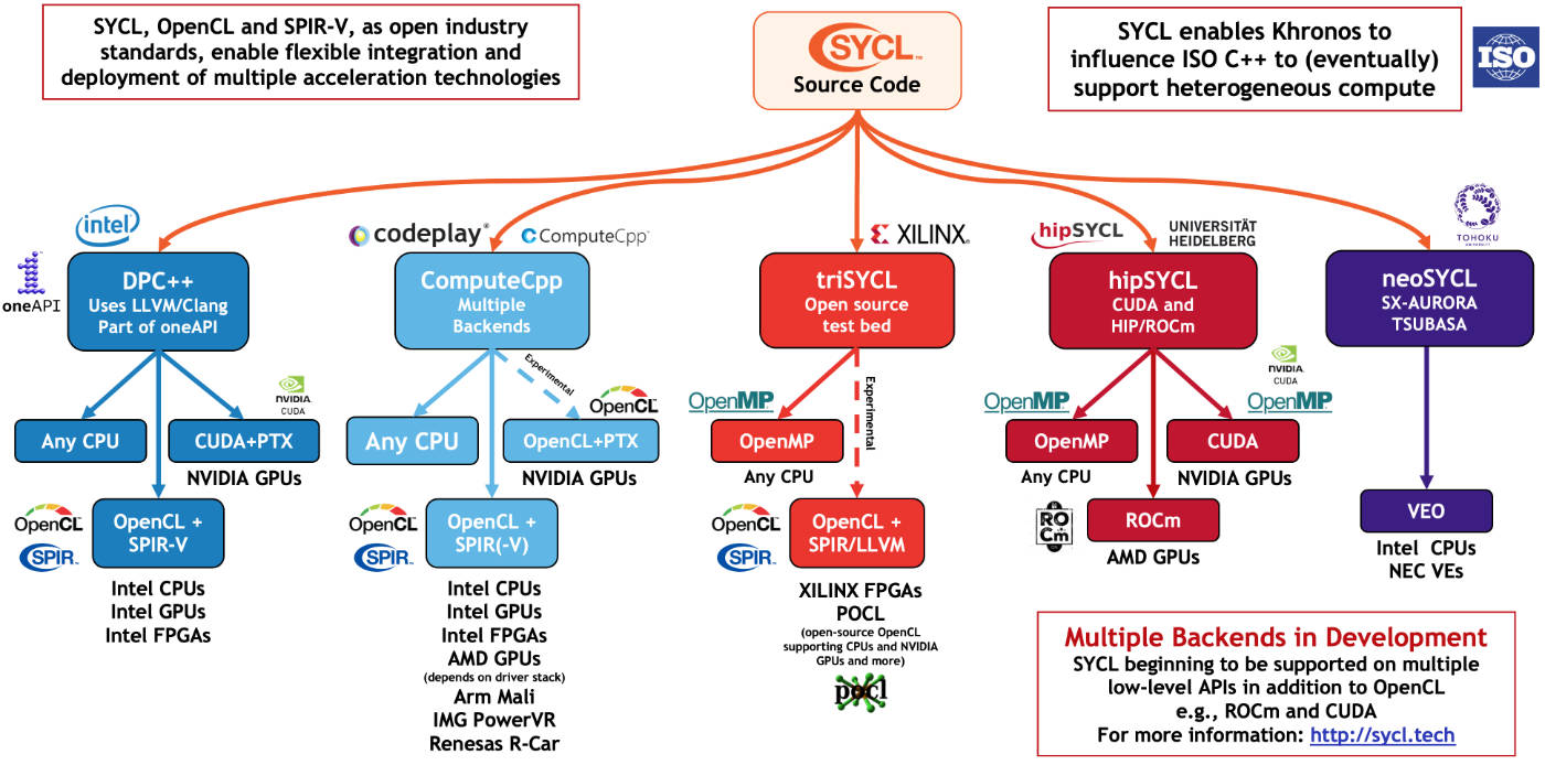

Based on that diagram I'm not really following how you're reaching that conclusion
The thread title reflects the linked news release and the trend in supercomputers (SYCL being selected as the programming model, replacing CUDA). The diagram explains the current implementation space, technologies and contributors involved.

CUDA still has the huge advantage for your "average Joe" use-case
Unquestionably, CUDA currently has immense advantage when it comes to ease of adoption in the mainstream.
Hopefully, AMD, Intel and others can get themselves into gear and collaborate on SYCL toolchain support, availability and ease-of-use on all platforms.
I guess it will happen eventually. The question is just how long it will take.
Here is what I would like to see: AMD, Intel, Nvidia and Xilinx (and others) should collaborate with Microsoft on getting SYCL support in Visual Studio (replacing the old C++ AMP extension). AMD and Nvidia should collaborate with Codeplay on getting good backends for DPC++ for their respective GPU architectures (as mentioned before, Codeplay just announced they have a contract to work on AMD GPU support in DPC++, and they have previously done work on Nvidia GPU support). This should cover Windows and Linux pretty well. Google should invest in support on Android, and Apple should do the right thing for their platform.
Reactions: Schmide
Cogman
Sep 19, 2000
10,284
138
Here is what I would like to see: AMD, Intel, Nvidia and Xilinx (and others) should collaborate with Microsoft on getting SYCL support in Visual Studio (replacing the old C++ AMP extension). AMD and Nvidia should collaborate with Codeplay on getting good backends for DPC++ for their respective GPU architectures (as mentioned before, Codeplay just announced they have a contract to work on AMD GPU support in DCP++, and they have previously done work on Nvidia GPU support). This should cover Windows and Linux pretty well. Google should invest in support on Android, and Apple should do the right thing for their platform.
What needs to happen first is others need to break into the GPGPU market in server farms. AMD's "Instinct" has been a flop and Intel's "Phi" didn't really go anywhere.
It's a chicken and the egg problem. In order for people to adopt OpenCL and SPIR-V, there needs to be market competition. In order for that to happen, OpenCL needs better support and there needs to be more cards on the market supporting it.
Sadly, all this points to nVidia and CUDA being the defacto standard for GPGPU programming for anything other than games.
Reactions: Tlh97 and Vattila
Vattila
Oct 22, 2004
817
1,450
Let's wait until MI200 is revealed. Apparently, AMD has capable GPGPUs coming, judging by the many CPU+GPU supercomputer wins.
Note that SYCL 2020 is now completely independent of OpenCL and SPIR-V.
"SYCL has been closely aligned to OpenCL, but over time has evolved into its own completely distinct programming model. The latest revision SYCL 2020 can decouple completely from OpenCL and therefore eases deployment support on multiple backends."
Argonne, ORNL Award Codeplay Contract to Strengthen SYCL Support for AMD GPUs (hpcwire.com)

HIP is apparently to be extended for FPGA use and integrating with Xilinx's current stack (yay more demand on AMD's stretched SW dev teams).
Also here is the full PDF for that Sylkan page.
I do wonder if there is some possibility of a 'headless' subset of Vulkan that could be created as an ultimate cross platform compute only backend for non gfx devices - ala NPUs/IPUs/TPUs, FPGAs, DSPs and other assorted accelerators.
Making it a subset of Vulkan could reduce API maintenance efforts for Khronos.
