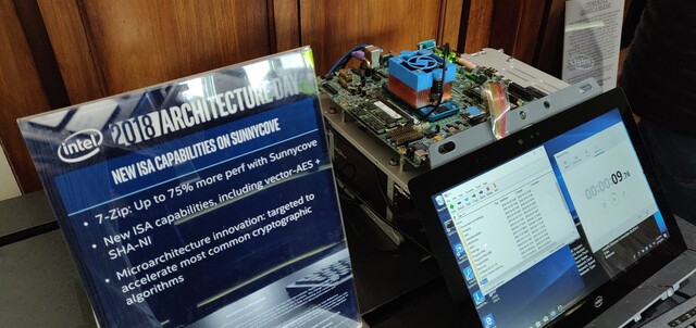

Or that you do not follow the news, it was in a slide posted by Computerbase with 7zip explicitly displayed, and also related by CdH :
http://www.comptoir-hardware.com/im...el-architectural-day-2018/kaby-lake-7-zip.jpg
http://www.comptoir-hardware.com/im...l-architectural-day-2018/sunny-cove-7-zip.jpg
http://www.comptoir-hardware.com/ar...re-day-sunny-cove-contre-attaque.html?start=1
Dunno who is actually imagination "figmented"...
That is absolutely no proof of some dedicated "LZMA block" if such a thing even exists.Looks like you don't even read the damn things you quote. Ice Lake is much faster than Kaby Lake simply due to its superior memory subsystem.

The integer workloads in Geekbench don't benefit from AVX512. There is no question of them being inflated.
You were not even aware of the slide i posted and apparently you didnt even notice that there s 65% better perf in 7zip, so much for not reading what is posted.
Actually Intel stated that it s 40% better perf/clock in 7zip, you are right, it must be due to the so much superior memory subsystem, much easier explanation than doing your homework .
Btw, from C2D to Haswell the improvement/clock in CB is about 50-60% while in 7 zip it s no more than 20% and Haswell has only 28% better perf/clock in ST than Piledriver.
It say that LZMA is very difficult to improve clock/clock , but seems that they are all stupid to not have thought that memory subsystem improvement could do in one gen what was impossible in 5 from C2D to SKL....
Your tendency for load of bs claims is just incredible. Basically what You claim is: Intel has some sort of magic accelerator implemented in Ice Lake for LZMA, that GeekBench is somehow able to immediately implement and utilize ( I guess for hardcore morons it is additional proof of conspiracy and collusion between Intel and devs of Geekbench ).
Simpler explanations like superior memory subsystem with 50% more L1 cache, more L2, 2 store ports and increased OoO and Mem parallelizm do not work when You have agenda to push forward.

That s all it is about, an agenda, lol, i guess that all that is left when arguments are short of logic, and go as far as negating evidences on the front of one s deliberatly blinded eyes...
I stated that they either implemented new instructions or a hardware block to increase LZMA througput, the slide above tell exactly what i state but still, there s people who argue against it.
That being said i never said that those instructions where implemented in Geekbench but that Intel claim of 18% better IPC is highly inflated thanks to such tricks, from here my conclusion is that we ll see nowhere something like 18%, and not even the 13.4% "computed" by my homework reluctant contender who stated that there were no such instructions or hardware block.
Now, and i already posted this opinion, if we look at the numbers displayed at Geekbench they show 10% better perf/clock in LZMA, and if, as you point it, the memory subsystem has a say in this number then it means that the CPU pipeline is not that better and that it s not an improvement entirely due to the uarch enhancement, a SKL with faster memory subsystem would had gained a part of this improvement if i were to follow your logic.

After a bit of thought, it's clear what is going on here. What Intel showed was a comparison of Ice Lake and Kaby Lake in compressing and ENCRYPTING with 7-zip. So of course with Ice Lake's new instructions the encryption part would be completed faster.
