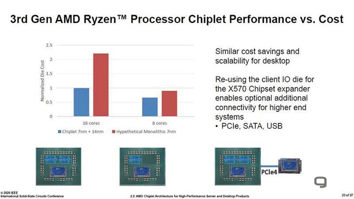

There was a clear declaration by AMD that chiplets cut down costs even in the 8 core desktop design
of course the biggest savings are on the highest core count CPUs.

There are many other 2nd order effects of chiplets besides what you're saying. You're only thinking of the simplest, yield @ fabbing cost.
One of the big ones is the ability to bin a CPU that will be impossible for a single unified die of equal core capacity.
Other big ones are design, verification & inventory cost savings.
