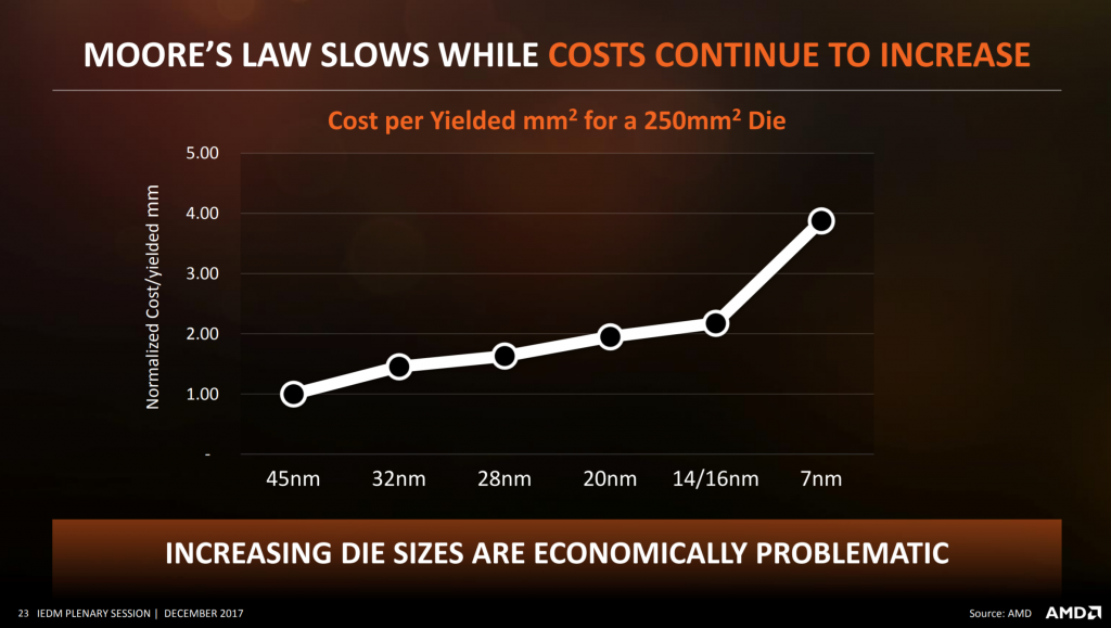

Is there any technical reason why 6C/12T is unlikely at $99? The 240GE isn't on TSMC 7nm so it's hard to just compare the two like that. If Zen2 was still fabbed at GF then sure, I think it'd be fair to call bs and say 6C/12T won't be 99$ because the 240GE is 75$. But, it's a new process with smaller die area, and probably relatively high yielding.
What you got wrong is that you think that you can just take something, and die shrink it to make it cheaper.
That used to be universally true back in the day, but the cost of smaller processes are becoming so expensive that is no longer necessary true.
amd-iedm-2017-23-1024x579-png.134744
That's the brilliance of AMD's approach though. Using chiplets, they can achieve much higher yields than they would otherwise be able to with a monolithic die.
The cost factor doesn't just increase as a result of the newer process being more expensive (on account of needing to recoup investment in its development) but also because it's immature. If you make a 250 mm^2 die on a new process, you might get fewer than a third of your chips back without defects. You can probably salvage a lot of the defective dies regardless, but they can't be sold for as much as a full die.
However, switching to the chiplet-based approach that AMD uses on that same process means that they can get closer to 70% full dies from the same wafer simply because the chiplets are much smaller (~80 mm^2) and less likely to have a defect. We're not very concerned with the IO dies since they're on the old, mature process so yields should be good.
This completely changes the economics and makes it feasible for AMD to continue to lower costs, even though the new node wouldn't normally allow that if it were just a matter of shrinking everything down.
The point of going with the chiplet design is to mitigate the price increase associated with 7nm.
Yes, you managed to mitigate the price increase, but it's still a price increase.
You're confusing process node with die size, and manufacturing costs with development costs.
A smaller die will always decrease manufacturing costs because of higher yield, more chips per wafer and overhead being spread over a greater volume. Cost per chip goes down.
A smaller process increases developmental cost. What AMD did to minimize that is having only 1 7nm die and the chiplet strategy.
