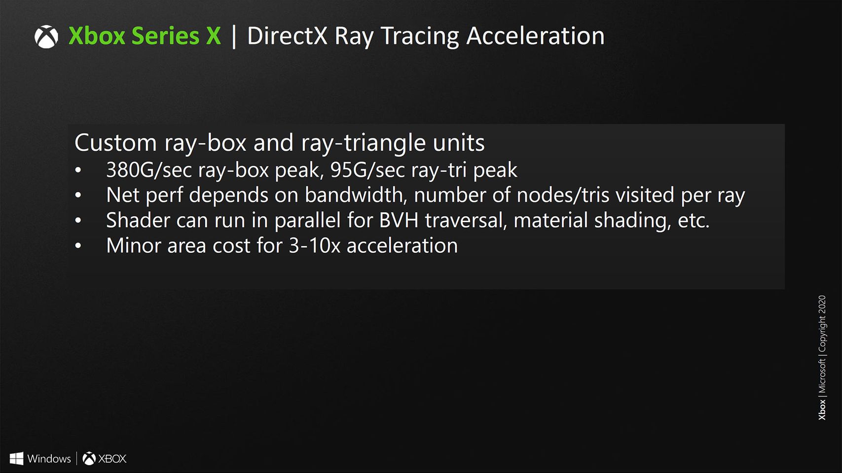

Some slides of the XBOX presentation on HotChips: https://www.tomshardware.com/news/microsoft-xbox-series-x-architecture-deep-dive
RT accelerator looks to be inside the TMUs like the patent. 4 textture OR 4 rays means that RDNA2 will trade texture fillrate for raytracing performance?
BVH run in parallel with the shader.
Pixel fillrate gain is massive. There was a rumor of some changes on the ROPs.
Direct ML can be used for resolution scaling. AMD response to DLSS?

Pretty much what is in the patent as I wrote before. Also the Ray Intersection unit is outside the Texture units directly coupled to L0 and LDS. So output stage from SIMD shaders goes into Ray unit via LDS and vice versa.
TL;DR;
AMD's Ray Intersection Unit containing HW for accelerating ray-box and ray-triangle intersection tests is present in the CU along side the SIMDs and not within the Texture Processor.
The previous circulated assumptions of the Ray Intersection Unit within the TMU is probably incorrect.
The Engine can perform 4 ray-box tests or 1 ray-triangle tests per cycle.
Therefore the publicized numbers of 380 Billion ray intersection tests per second for XSX is actually for ray-box intersection.
