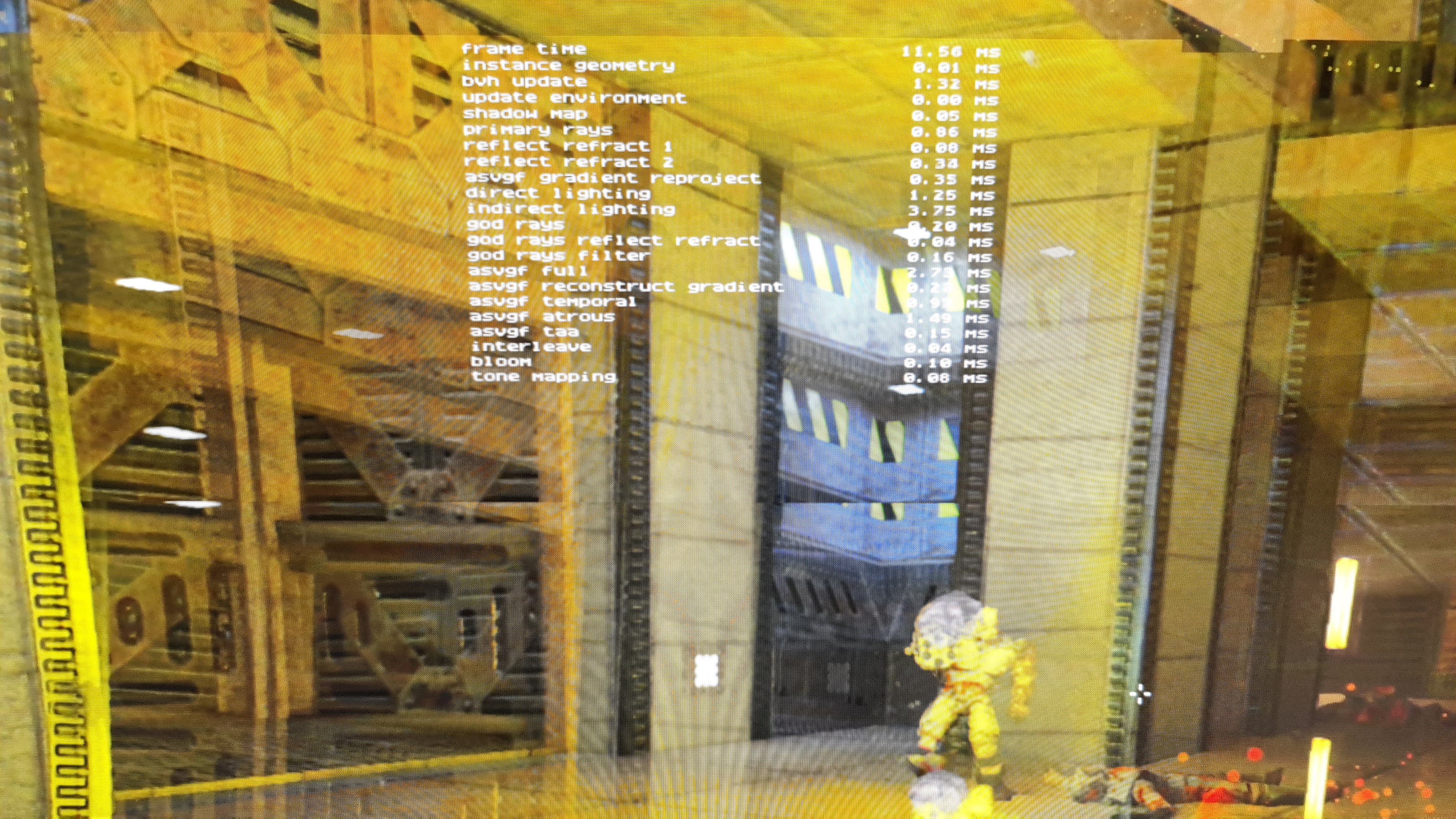

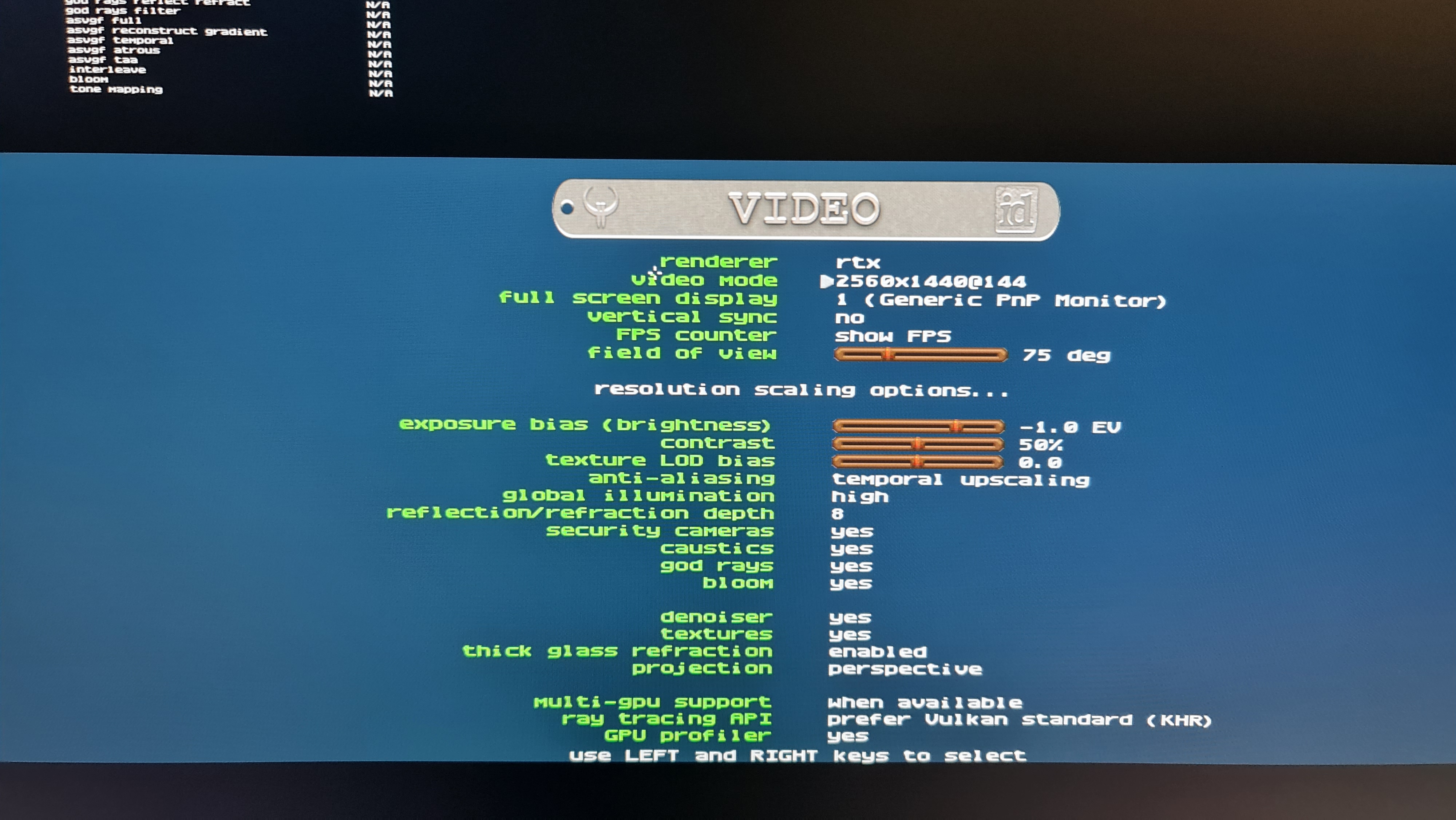

Just tested Quake II RTX on my overclocked RX6800XT and I'm happy with how it performs as I had very low expectations to start with.
Good news is, it works and it performs better than RTX2060 I had a chance to play on previously.
Full details with Upscaling AA:
1920x1080 = 79FPS on Demo1 map
2560x1440 = 48FPS on Demo1 map
I took few photos as screen grab was turning black screens form fullscreen mode.
Top pictures are QHD and the last two are FHD
