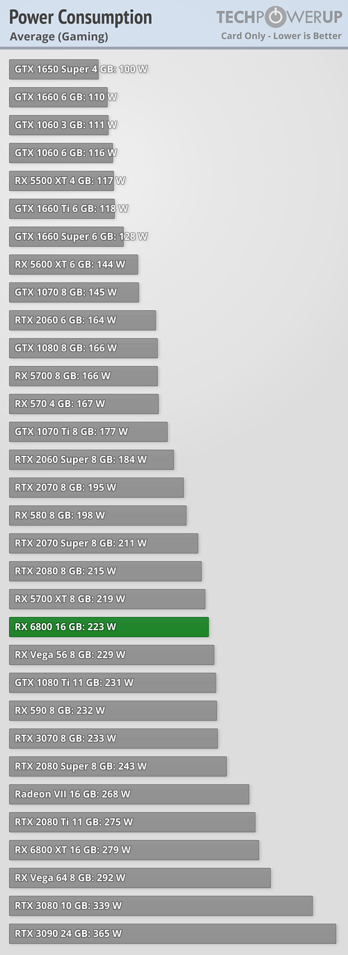

Glo.
Apr 25, 2015
5,930
4,991
This is absolutely mental efficiency.

Mopetar
Jan 31, 2011
8,532
7,795
Yeah that's nuts when you think about it. It's the same TSMC 7nm process, but AMD has managed to get the same amount of power draw from the 6800 as the 5700 despite adding 20 additional CUs and increasing the base clock by 350 MHz.
I mean I'm looking at the actual results, but I still don't quite believe it. Just insane.

Glo.
Apr 25, 2015
5,930
4,991
@Glo. That's crazy. AMD sandbagged hard on their efficiency claim.
Scrap that review.
TPU has done some errors in their testing, since both their power draw, AND performance numbers are way lower than anybody else's.
Reactions: moinmoin and Tlh97
